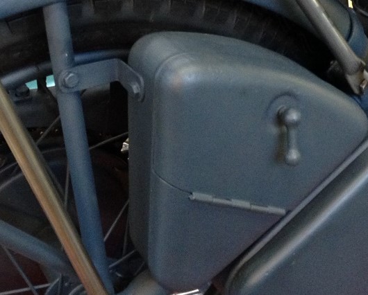

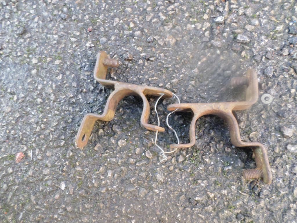

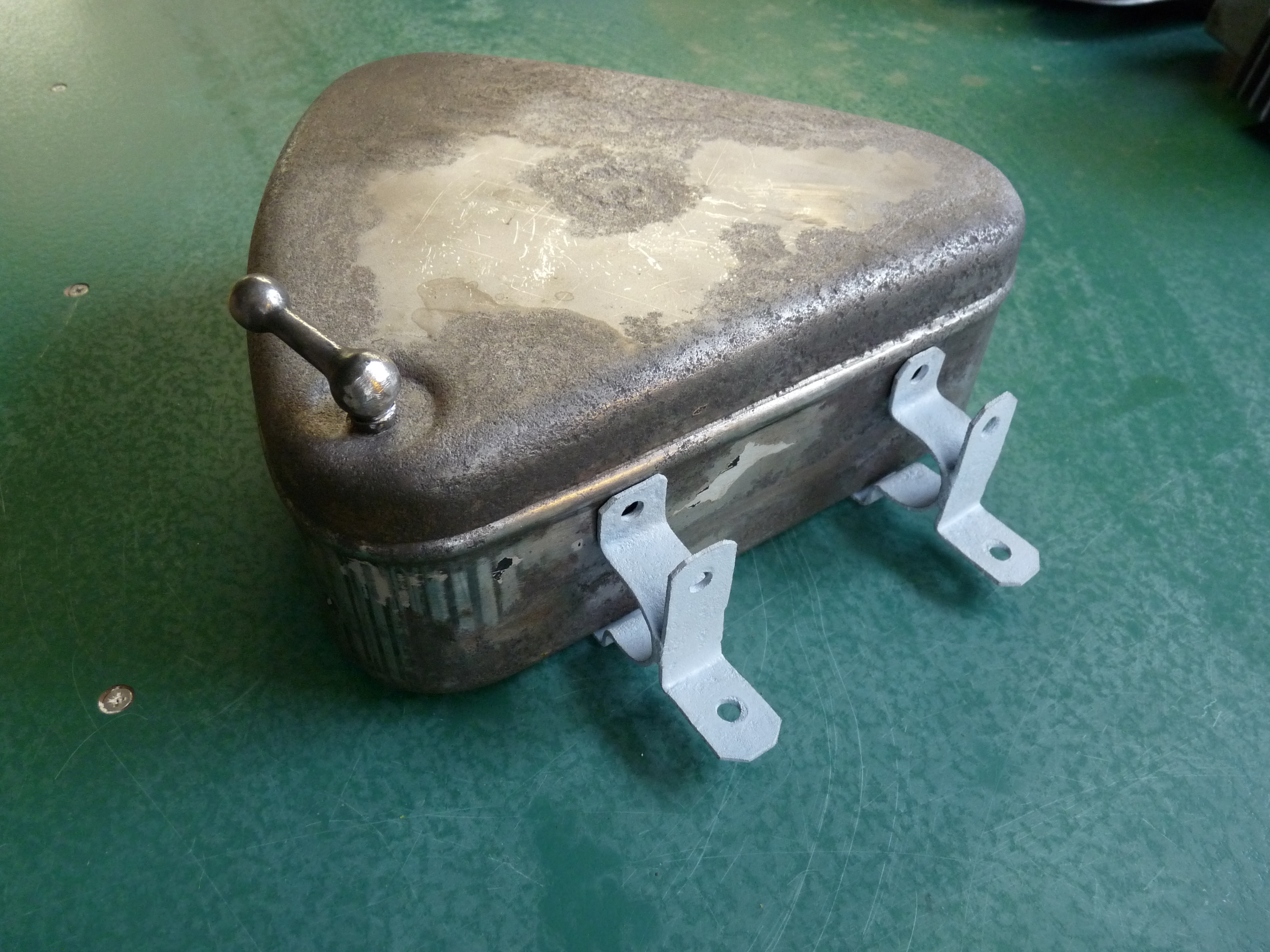

- Posts: 4900
Re: W/NG Tool Box
Hello Simon,
This is how the brackets look like in between the lower and uppertoolbox.
They are standard brackets with small angled strip welded on them, pretty easy to make.
This is - I think - how the top bracket looks, but I am not sure...
