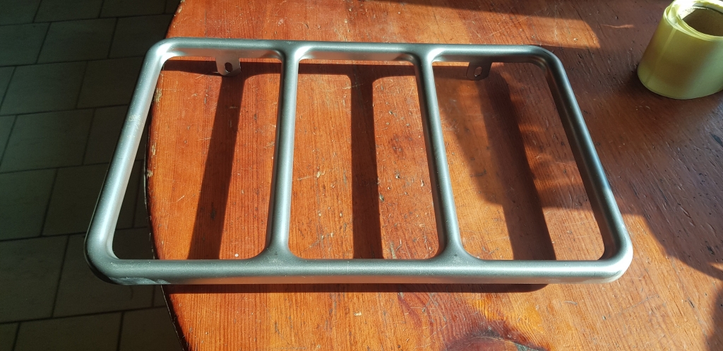

Re: W/NG Rack / Carrier / Panniers
If those early racks are a pressed item than maybe this one?
https://www.arielklub.sk/inzerat-2533-1 ... 4F-1932-34
The correct one is 5630-40 that will be the same as 5630-35 but with slightly different legs. The difference between the 1930/32 carrier and the 1935 one is that the latter has the legs fixed in place, whereas the earlier ones use loose legs or brackets as in Vincent's picture. Drawings for all parts for the -35 carrier are available to club members.
We have the top in stock, but you have to make the legs yourself.
