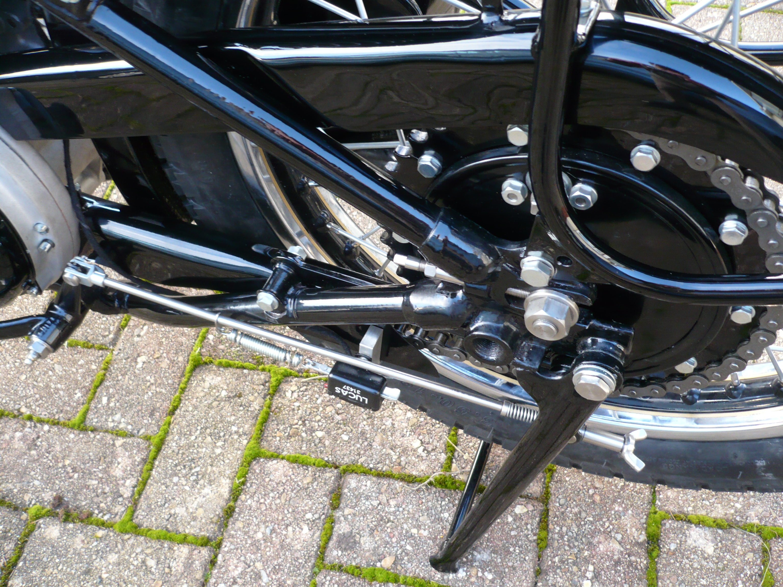

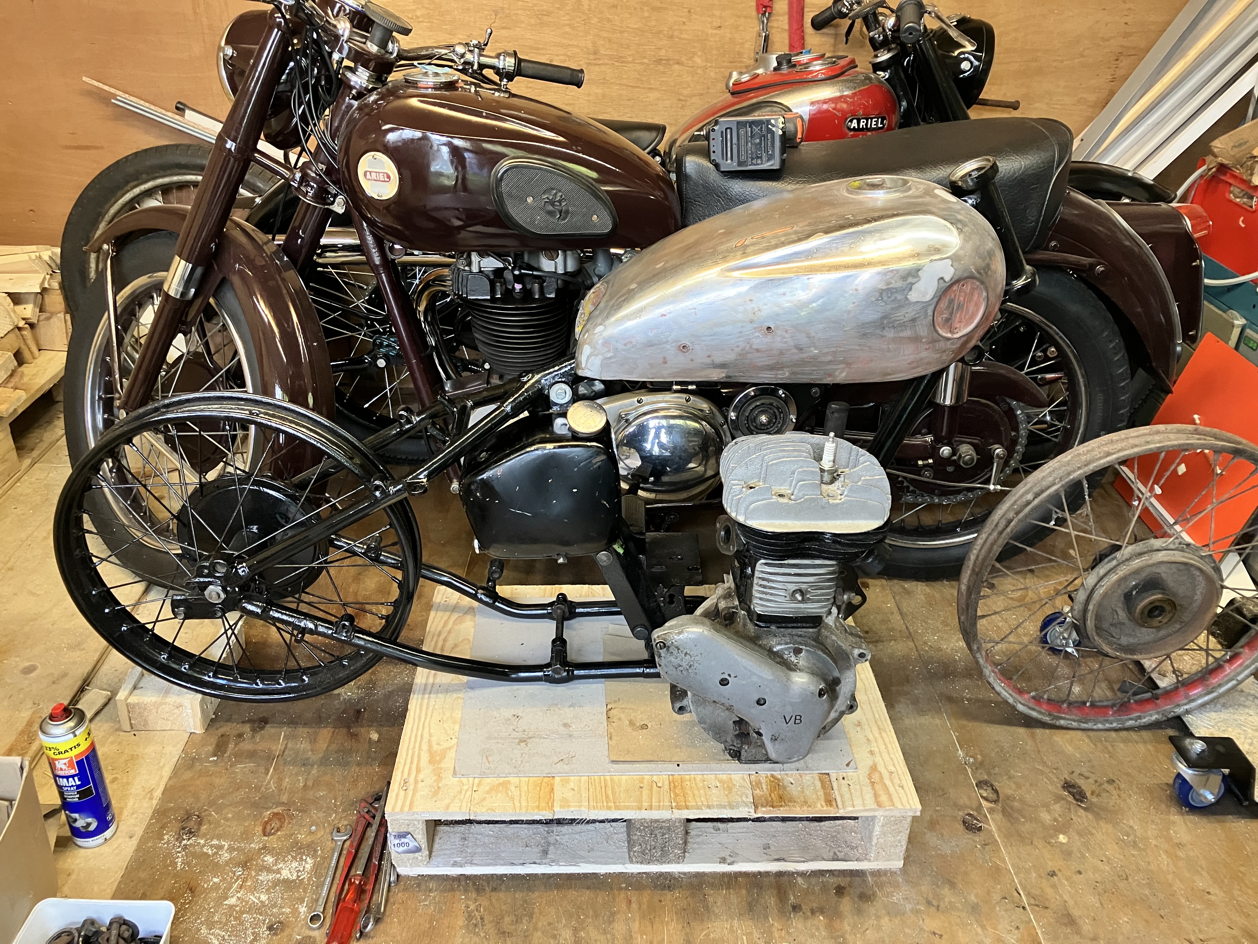

Following on from my Mk 1 very successful rebuild I bought a VB but sadly not a girder fork version I have been looking for but this very sad looking VB unseen off ebay, it failed to reach reserve but later we agreed on a price and I picked it up from Exeter, it sat in the van for few weeks until I was able to see what I had bought
It had a V5c and dating certificate it's history is it was exported from the factory to Denmark 2/10/53 finished in black, solo gears, sidecar fork springs
and 180KM speedo. It came back to UK at some point and was registered and issued with a V5c to Andy Tiernan in 2019. I was hoping to make an oily rag out of it but sadly it was in such poor condition I had to rebuild it totally, top to bottom

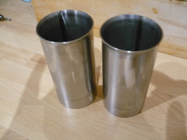

I was going to go into detail but you all know what it takes and below are a number of photos of the build, I did make quite a lot of parts including fork seal holders, battery carrier, side stand plus a lot of other stuff, any questions please ask. Seems I have reached max on photos will add some more later

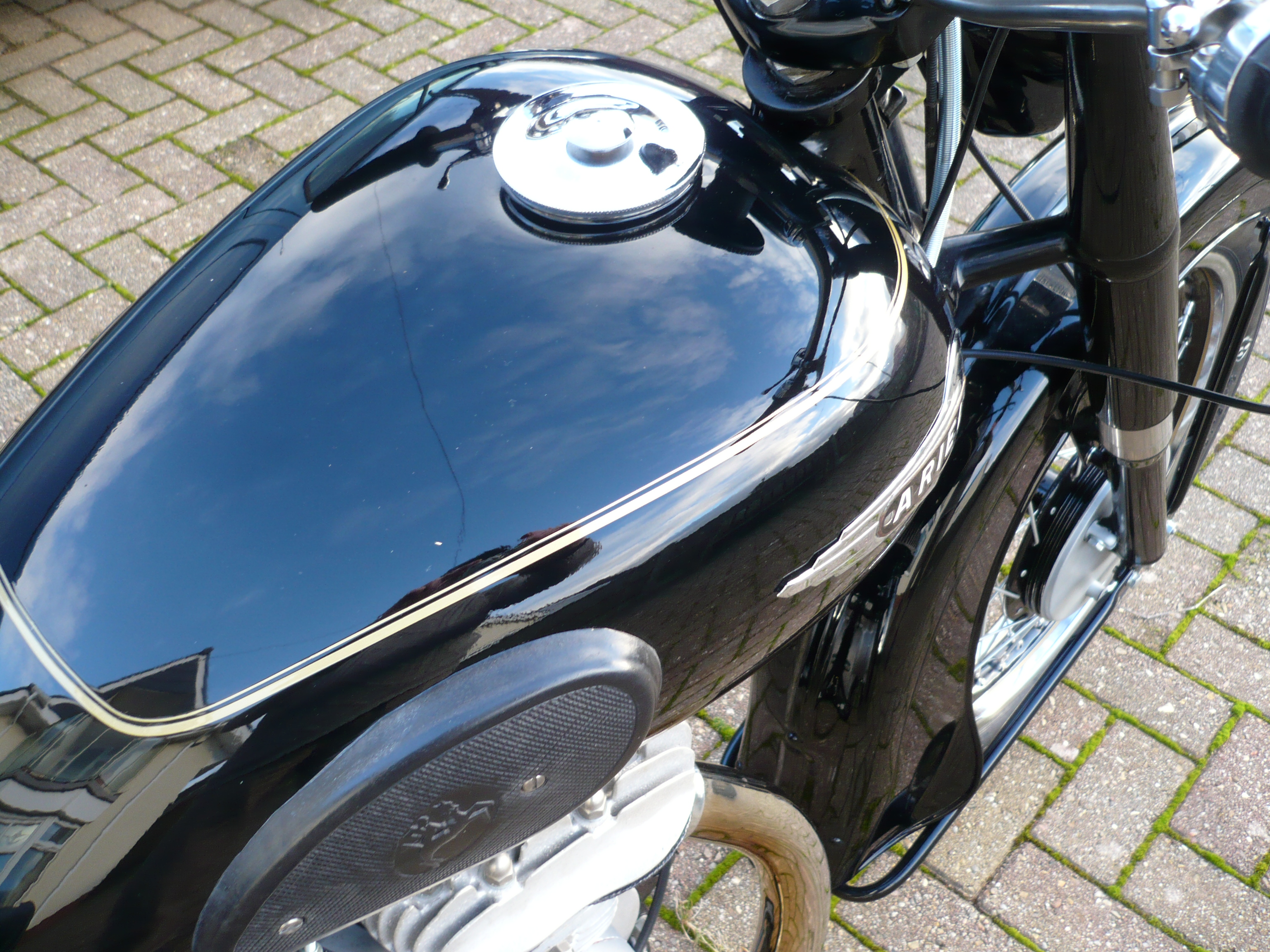

Very nicely done, I hope you don't think it too nice to ride it! Personally I would have given it a good clean and kept what appears to have been the original paint.

Very smart.Paintwork looks fabulous.

Beautiful work. I like the way you made that battery carrier. How did you get the alloy so clean?

Roger and Karol, as I said in my post I did want to keep it as an oily rag but on inspection it was in very bad condition, the three coats of paint were the least of my problems, rims and spokes rusted and not safe. brakes worn out, rear mudguard almost rusted through in places exhaust pipe and silencer needed replacing, wiring burnt out, a full engine rebuild along with mag and dynamo and so many nuts and bolts were replaced in it's life with metric spoiling the threads all needed helicoils. The only part of the bike which was in decent useable condition were the fork internals, but most of the machine was original and I had all the chrome work replated all the tinware repaired and as all the work is done in my garden shed I am very happy with the finished product and as to the economics of the rebuild it's a hobby not a business, been a hobby of mine for fifteen years since my wife passed away it gives my friend and I great pleasure and enjoyment in our retirement and who else benefits from my hobby? well on this rebuild it was Draganfly (who would have benefited more if parts were in stock), along with other suppliers Armours, CWC, Quality Chrome, Rutland Dynamos Nookys Nuts plus many more.

SEDoan, I have the alloy castings aqua blasted locally and I don't polish them only a wipe down with petrol on a rag, doesn't look right on all machines but I like the look.
