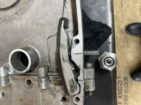

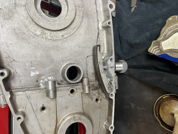

Next on the list I am planning on adding a sidecar so need an easy way to keep primary chain adjusted correctly pulling the extra weight.Drag shoe is on the slack side of the chain, O ring seal on the lock nut.
Mike
