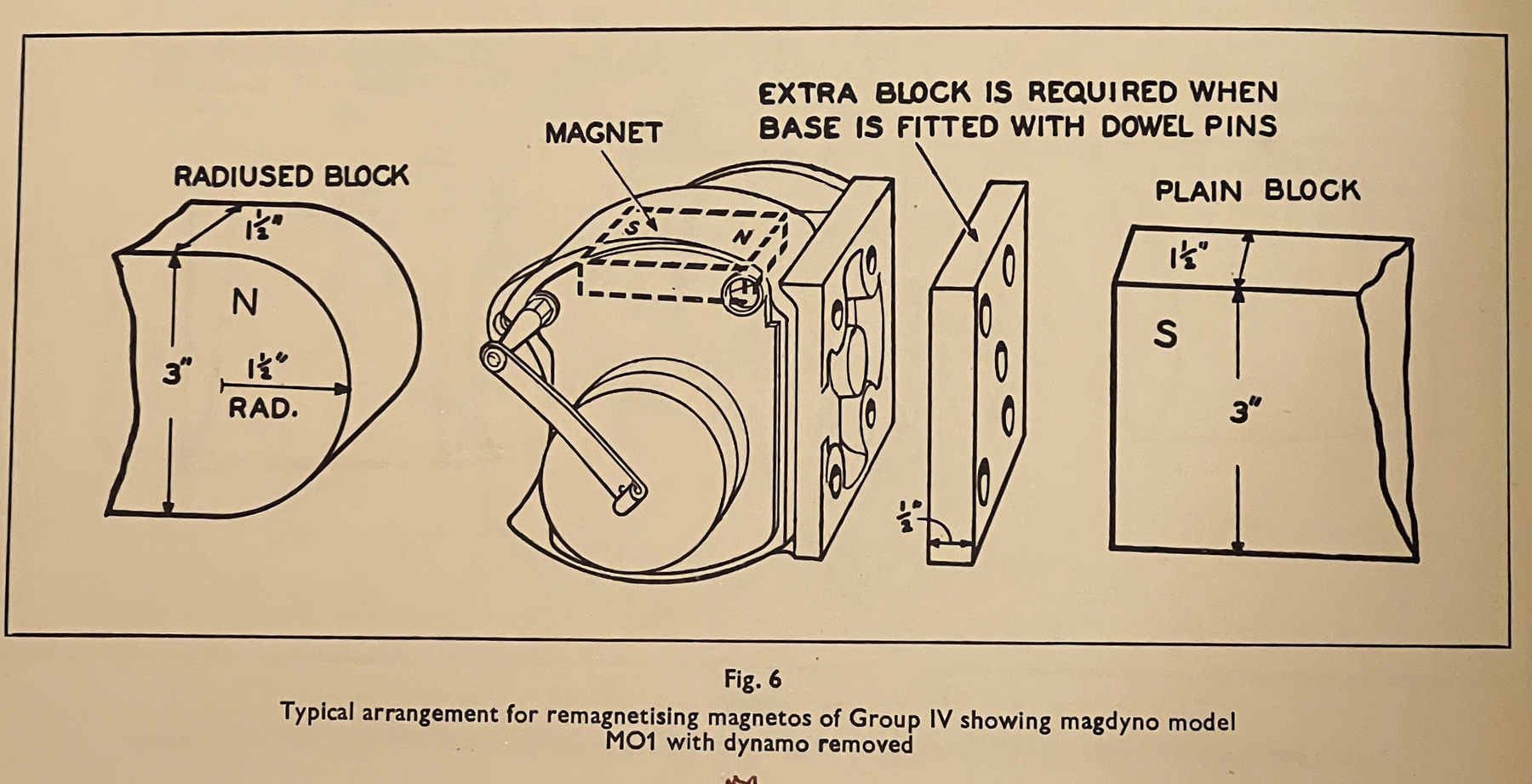

The link from the Magneto Guys' site (https://www.themagnetoguys.co.uk/remagnetising-magnetos)
to a Lucas publication on remagetisation is worth following.

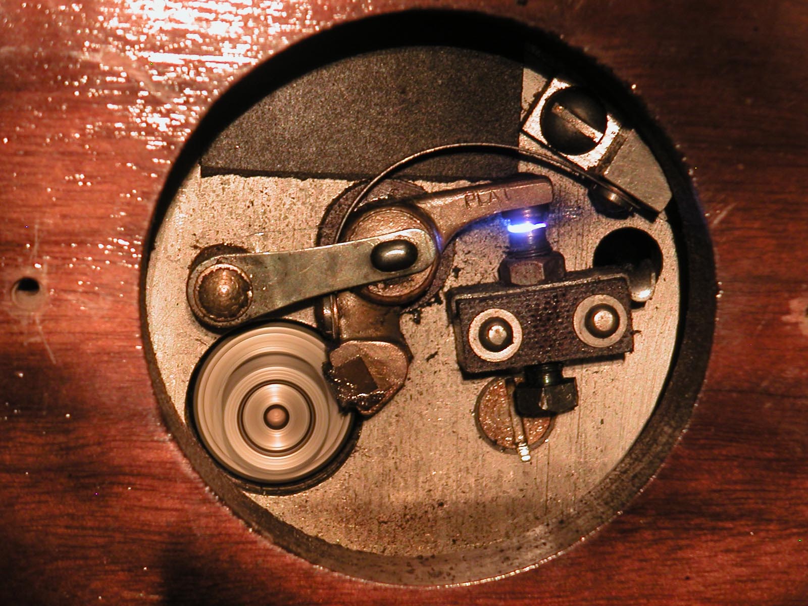

An excellent, "non-invasive" test of the condenser is to look at the points on a running engine. A good condenser will result in nothing more than tiny pinpricks of light between the points.
I should add that one of the magneto testers I have allows me to install a magneto armature without its capacitor, and then add a capacitor of my choice externally. Using a sensitive spot light meter with close-up lens, I measured the brightness ("luminance") at the points when a series of capacitors of measured "badness" (ESR -- electronic series resistance) were placed in the circuit. Without going into the details, ranging over a factor of ~100× of both, basically there was a linear relationship between the brightness of the sparks at the points, and the "badness" of the capacitor. What this experiment means is the brightness of the sparks at the points is an excellent substitute for an electrical measurement of the condenser, which only can be done by cutting the condenser from the circuit.
The following photograph shows what I mean by using the sparks to diagnose the condition of the condenser, although it is deceptively bright because it was a 3 sec. exposure showing a composite of ~75 sparks.

nevhunter wrote: Sun Sep 03, 2023 3:47 amThe magneto I have the Most difficulty with is the Lucas Magdyno because you can't get contact with the Magnet itself except on the earlier models where it's removable and you'd need a keeper there to assemble it in the best way
I don't understand. You can't get make direct contact with the magnets on KNC, KVF, etc, either, because the magnets are encased in the aluminum housings. As the Lucas diagrams show, each of these requires shaped pole pieces for the electromagnet, to bring them as close as possible to the encased magnets in the magnetos. A keeper will do no good for any of these because the loss is nearly instantaneous when the armature is removed. No matter how quickly someone works, the horse will have been long gone from the barn before a keeper could be inserted. Or, if the bare housing is magnetized with a keeper in it, the same nearly-instantaneous loss will happen when the keeper is removed to swap it with the armature.
Posts: 5643
Re: Magneto Magnet strength ?
As I said the "earlier" model has removable magnets and these would need a keeper. while the Magnet was being moved. Alsowith the armature in place a lot of the magnetic lines of force end up going through the armature. Nev
