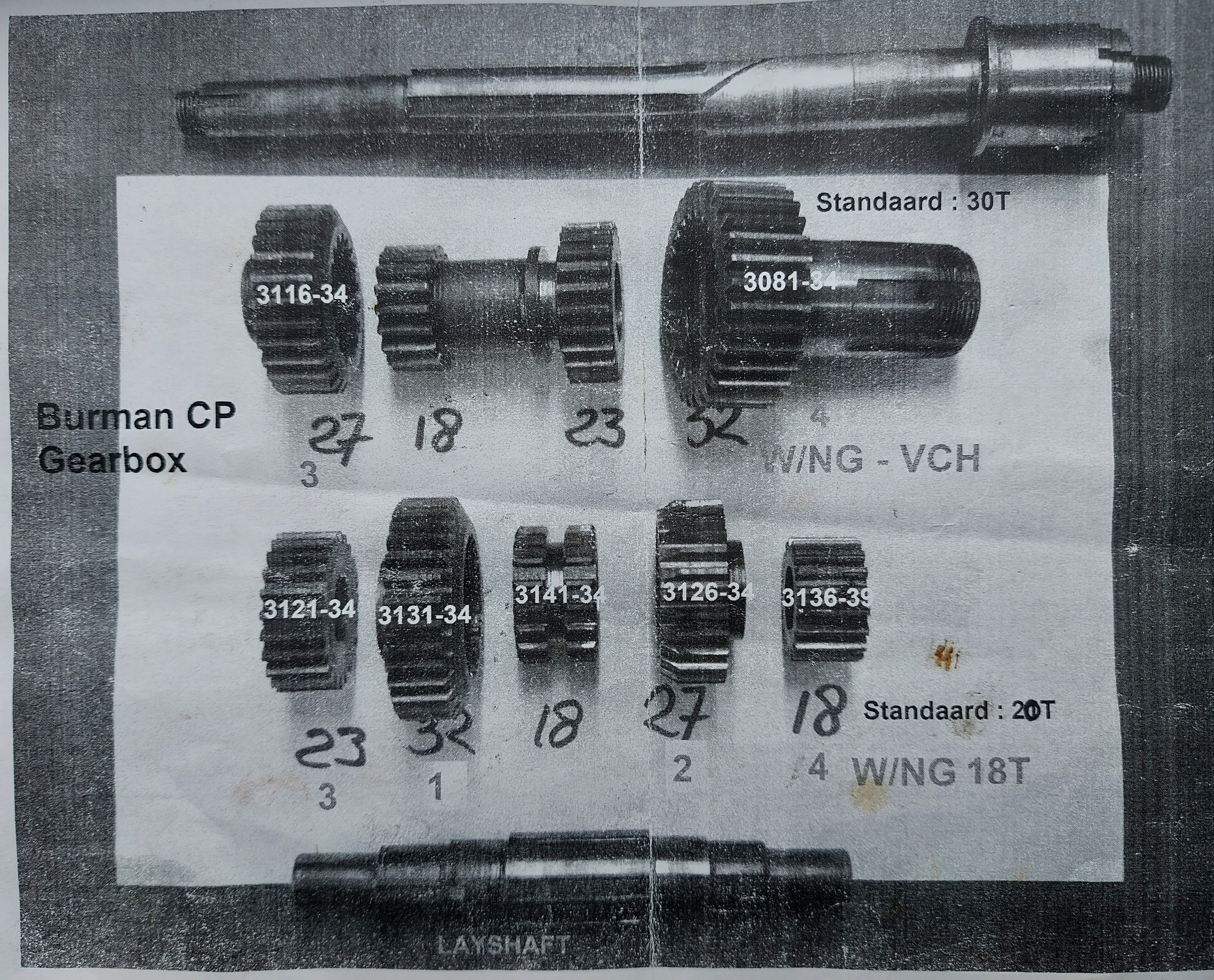

Hi, sorry for the bad copy, I could not find my original photo.
4th mainshaft gear WNG/VCH = 32 T . Civilian = 30T
4th gear layshaft WNG/VCH = 18T. Civilian = 20T

That's very useful Vincent, thanks!

Note matching gears teeth all add up to 50. There's the answer to the VCH too where the CP box is a listed option. MATCHLESS/AJS tended to use the smaller box with their 500 cc bikes even the 18 CS. I reckon that Trials ratio box is a pain to ride having done about 15000 miles on my W/NG before I converted it.. One thing is the speedo is driven from the front wheel but look after the greasing and adjusting of that as the Gears will suffer if you don't. I found out the hard way and they are "EXPENSIVE" IF you can even get them. The Perils of doing REAL miles on some of this stuff. Nev
