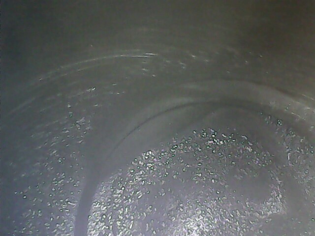

Then I put the camera down the plug hole.
The first picture shows the view directly down the plug hole onto the piston - quite a lot of carbon and it's wet because I had been kicking it over looking at the valve clearances, but you can see a nice shiny polished surface on the bore:

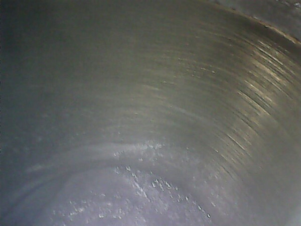

This next one shows the hone marks still visible on the timing side. Folk on the FB group have pointed out that the honing marks are not angled enough:
This is what they looked like fresh from the machine shop:
This view is of the area under the exhaust port. Nice and shiny again.

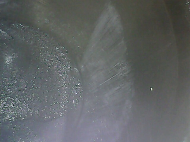

Here's the money shot. This is the thrust face, under the inlet port - looks like a partial seizure
So, it appears that the top end is coming apart, at least to check the condition of the rings, small end, and to improve the hone. I'll measure the bore and piston diameters to check they are suitable, but the bike has done 2500 miles since rebuild and running at 55 or so is not that unusual - especially if Holyfield Junior is riding it.
