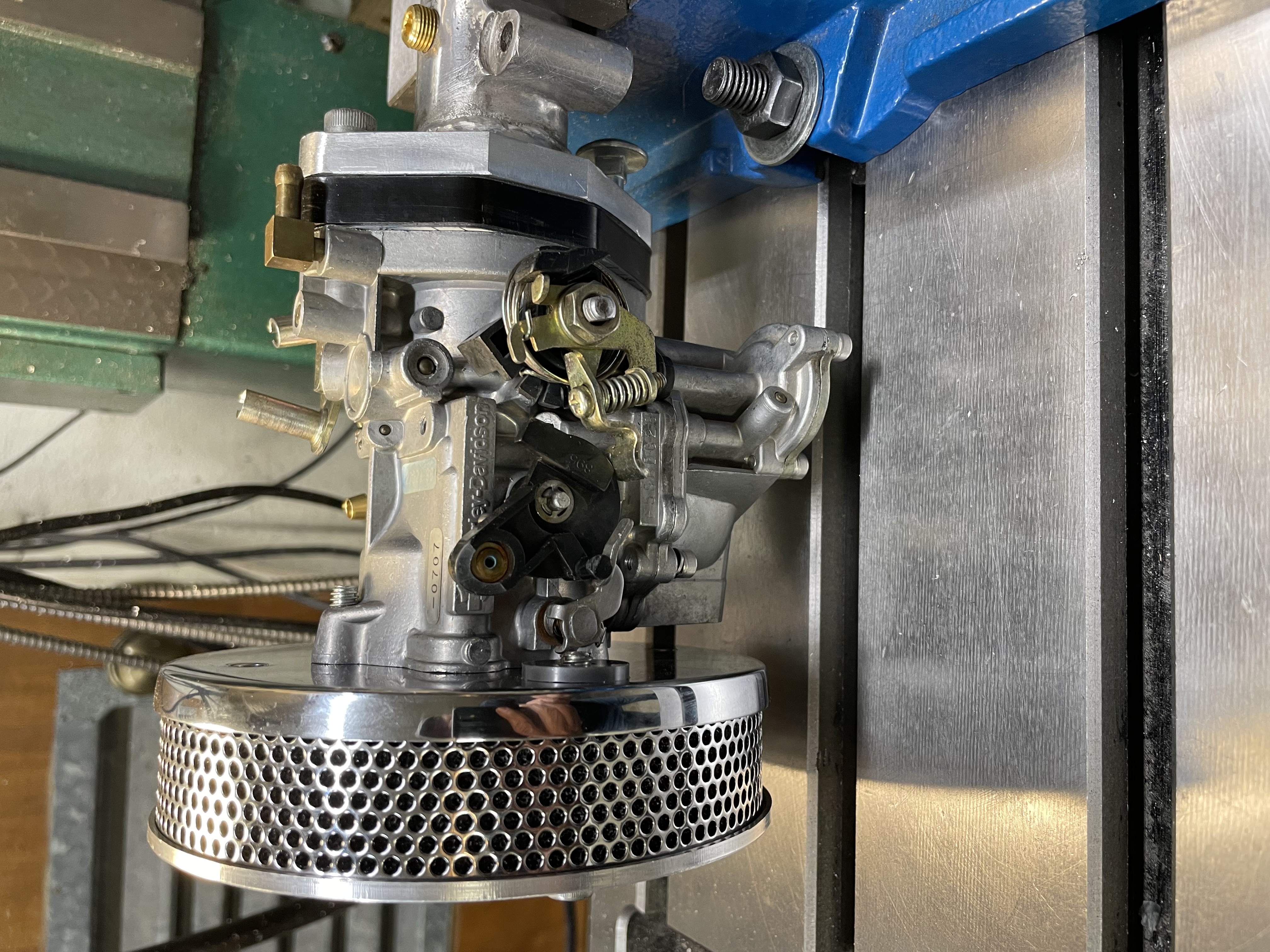

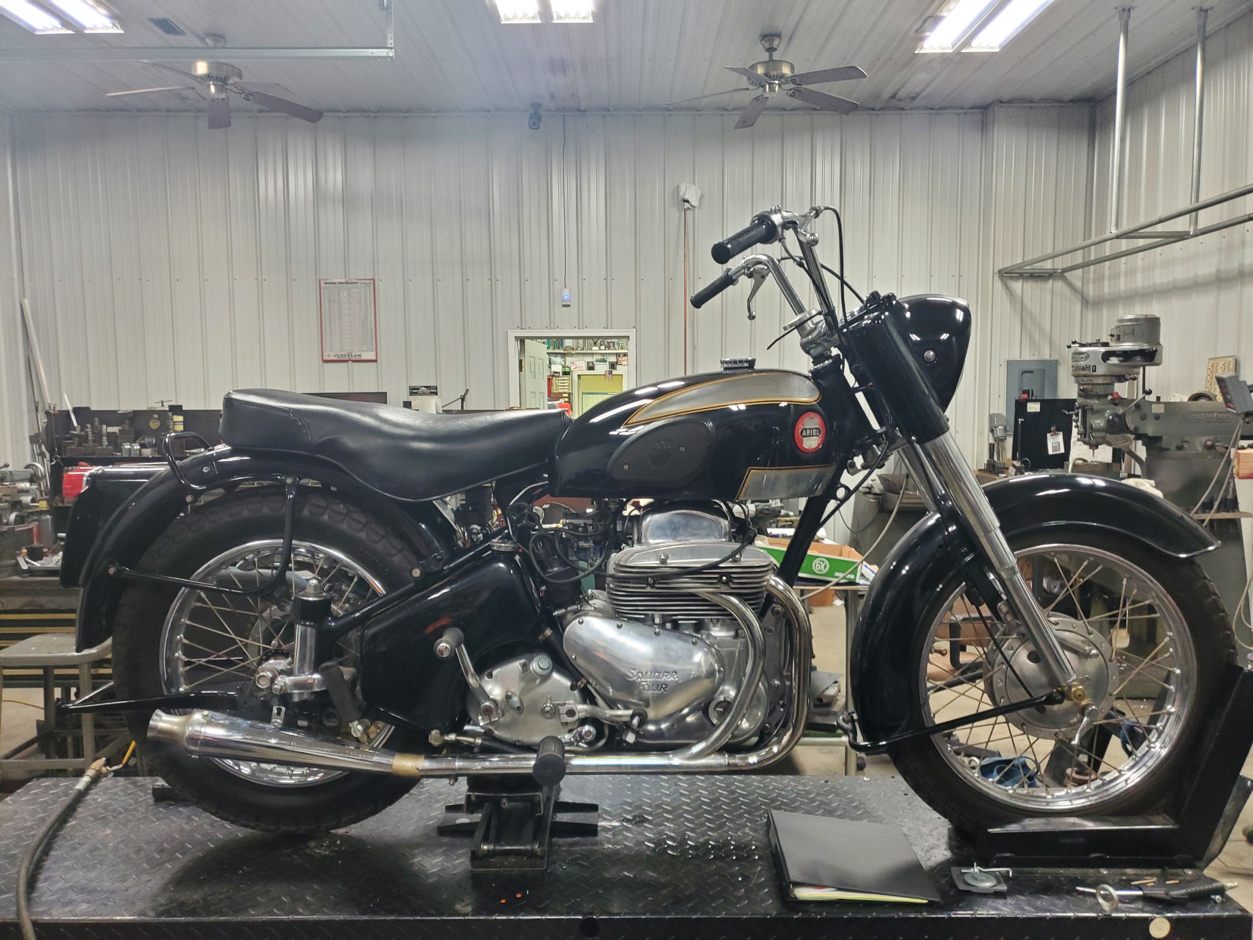

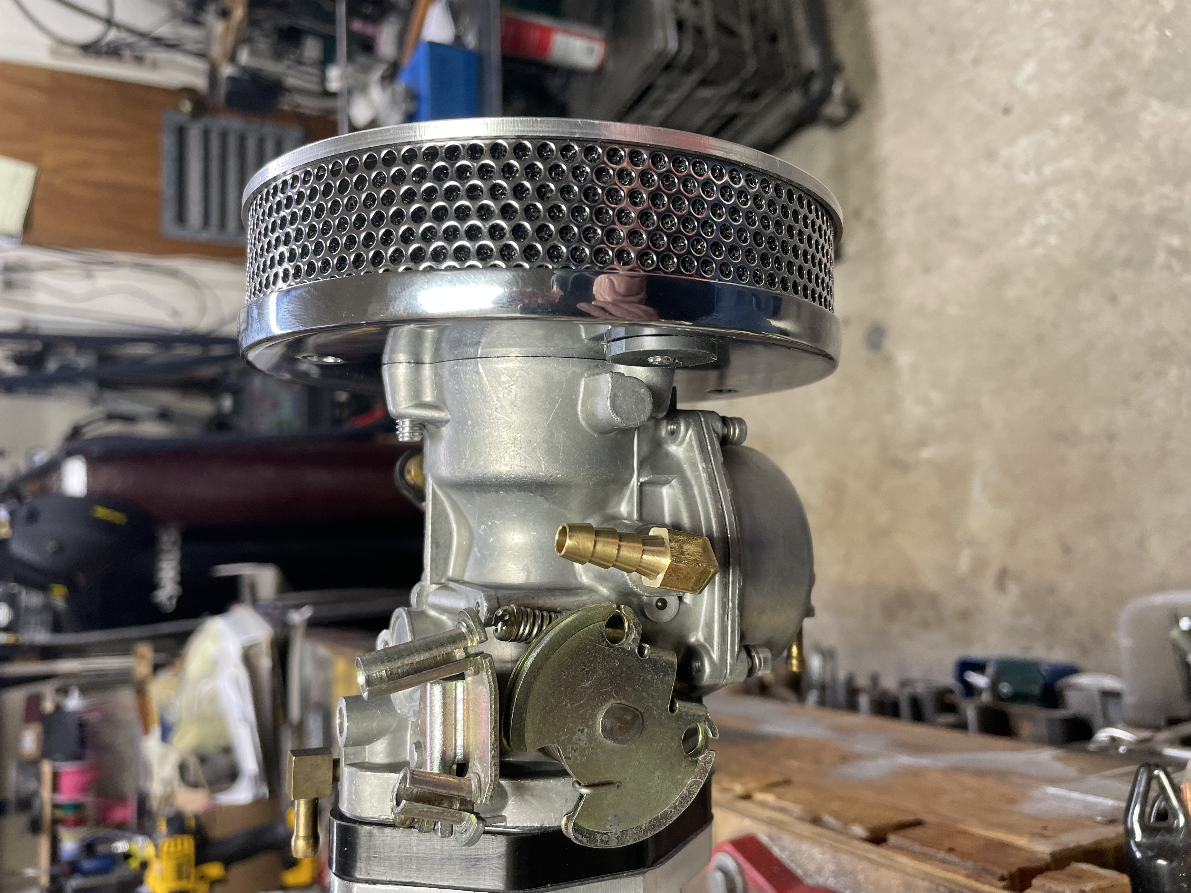

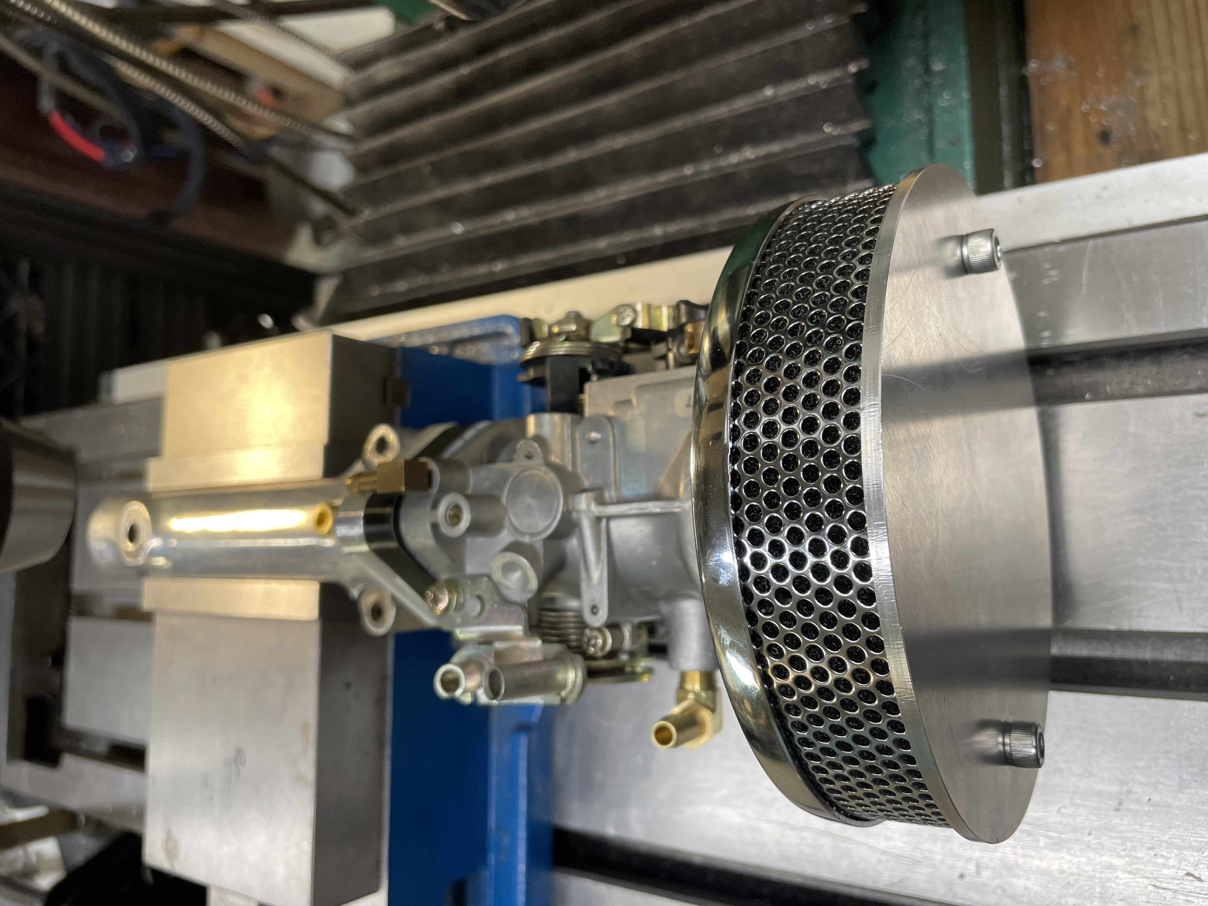

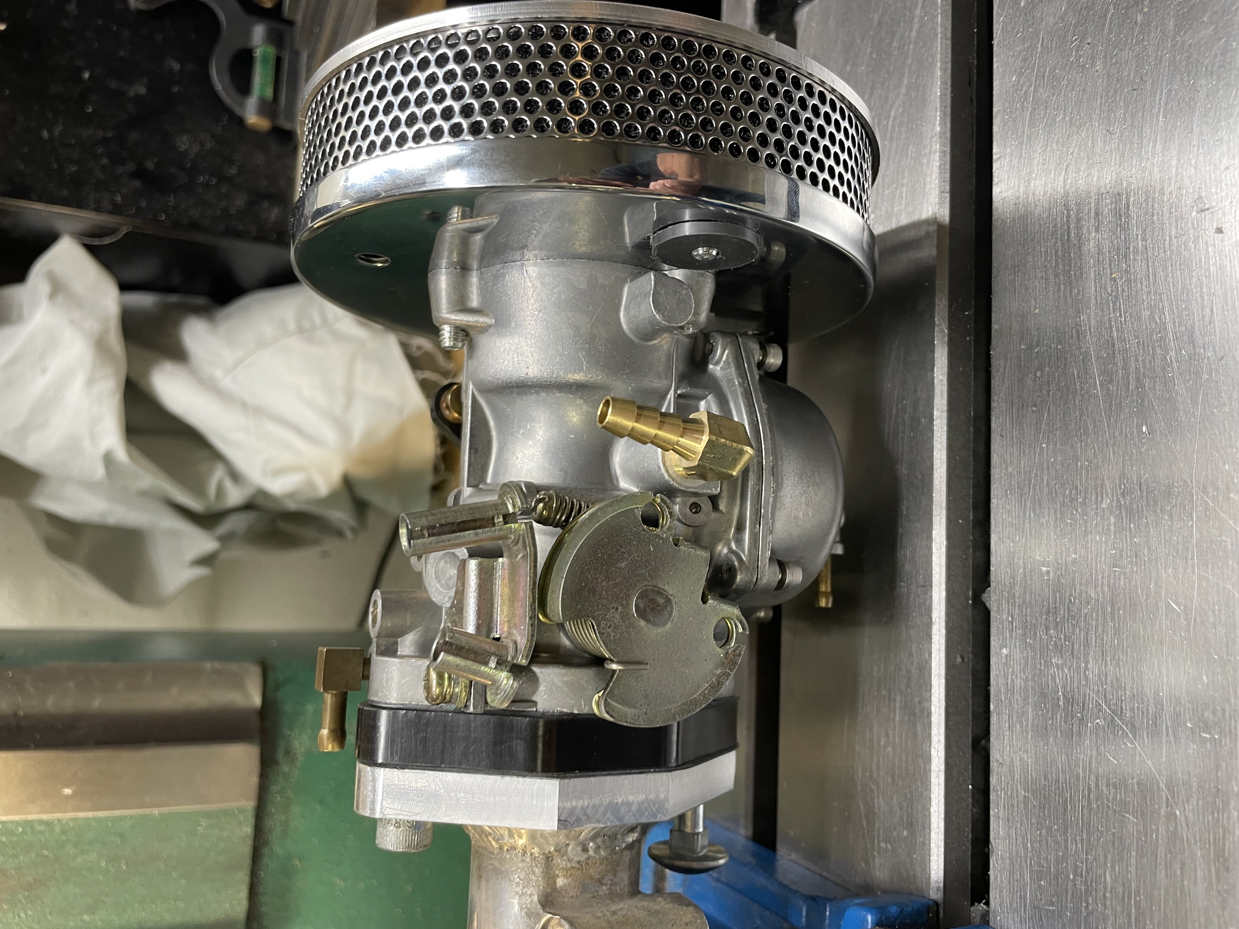

I am always looking for better performance,my Mark ll came with an Amal carb which after tuning motorcycles for many years fell a little short of my expectations.Since owning a V Twin performance shop I have an abundance of used 38 mm Keihin butterfly carburetors.Decided to upgrade and replace the Amal.Note this is circa 1995 vintage,has an accelerator pump and all the jets you could imagine available today.These were used on 1000,1200 and 1340 cc engines.I did have to modify the intake manifold to accept the Keihin.What a difference!Questions,coments?

As you "have an abundance of used 38 mm Keihin butterfly carburettors" how about offering upgrade kits to club members

Will the Keihin fit in place of the Solex, or is it too big?
mike.loehr
- Posts: 21
- Joined: Mon Apr 11, 2022 4:56 pm
Re: Square 4 carburetor replacement
I do believe they will fit in the space,I would have to do some research on that.
Mike
Mike
- Posts: 5591
It's a bit big in the throat but the pumper should overcome that. Single carb FOURS don't need a big carburetter but they do need a butterfly type throttle action.. It runs 2 throttle cables. One for closing, A good set up. Trouble free unit. Nev
