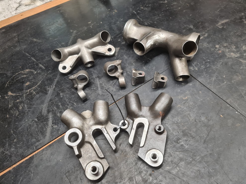

Wow! Thats quite a project. Are you going to remake the frame or look for a replacement?

we will repair the frame. I have already prepared suitable steel castings. We will keep its original parts. It is a motorcycle imported to Czechoslovakia by Štepář - Hanák on April 6, 1932 . I also prepared molds for making the fork, if it is not possible to find a suitable original.
- Posts: 5738
Re: Ariel SB/1932 my new project
Lovely Castings, Karol. You make it look easy. Nev
