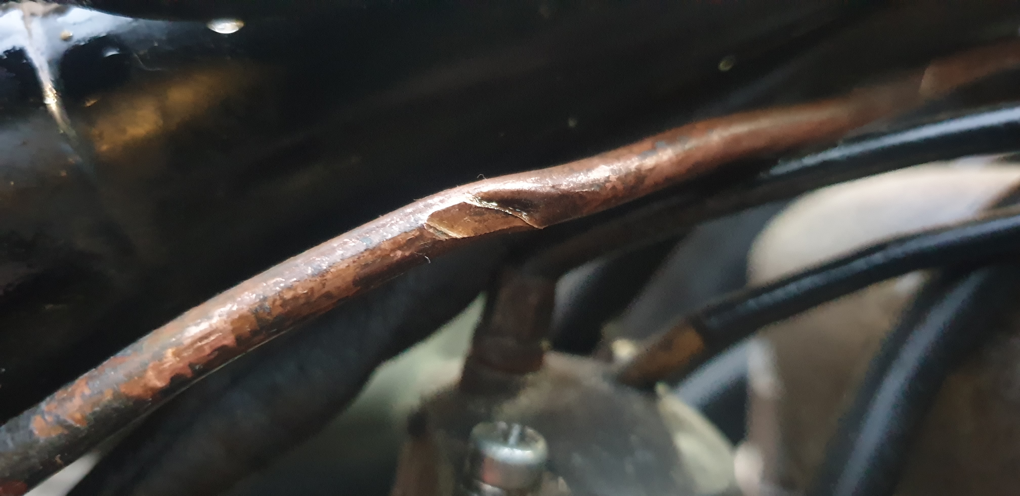

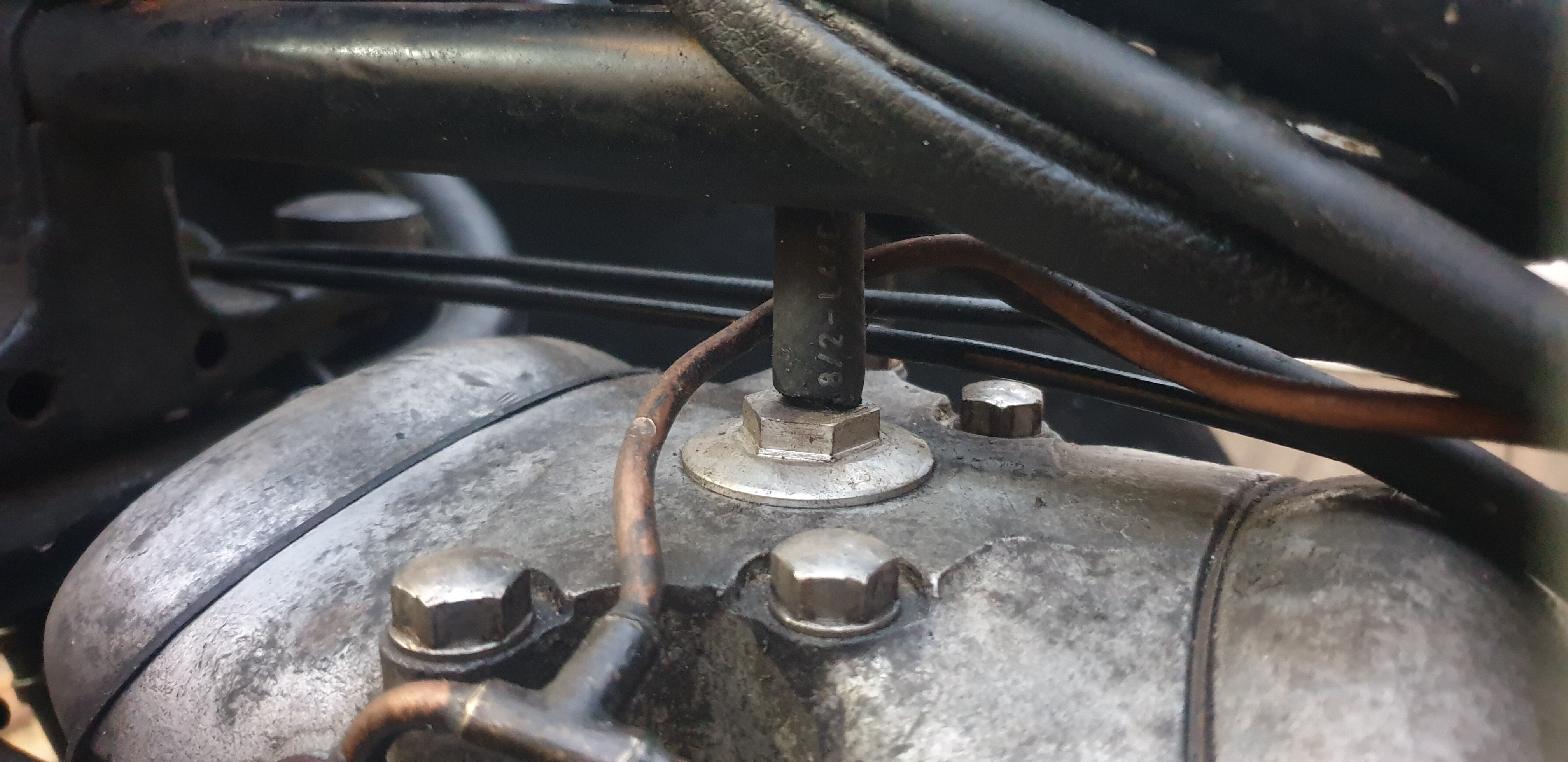

I'm hoping things have settled down with my bike, my breather mod seems to have brought my oil leak from the rocker box under control but all around the top of my air filter looks very oily. This morning I tightened up two jubilee clips that connects my copper pipe to the rocker box as it looked a bit suspect. But I was wrong.
Now I'm just back from a ride to Armours in Bournemouth to pick up new simease stainless pipes. And again oil everywhere around my air filter,
I've found the leak, copper pipe was rubbing against the petrol tank and wore through.

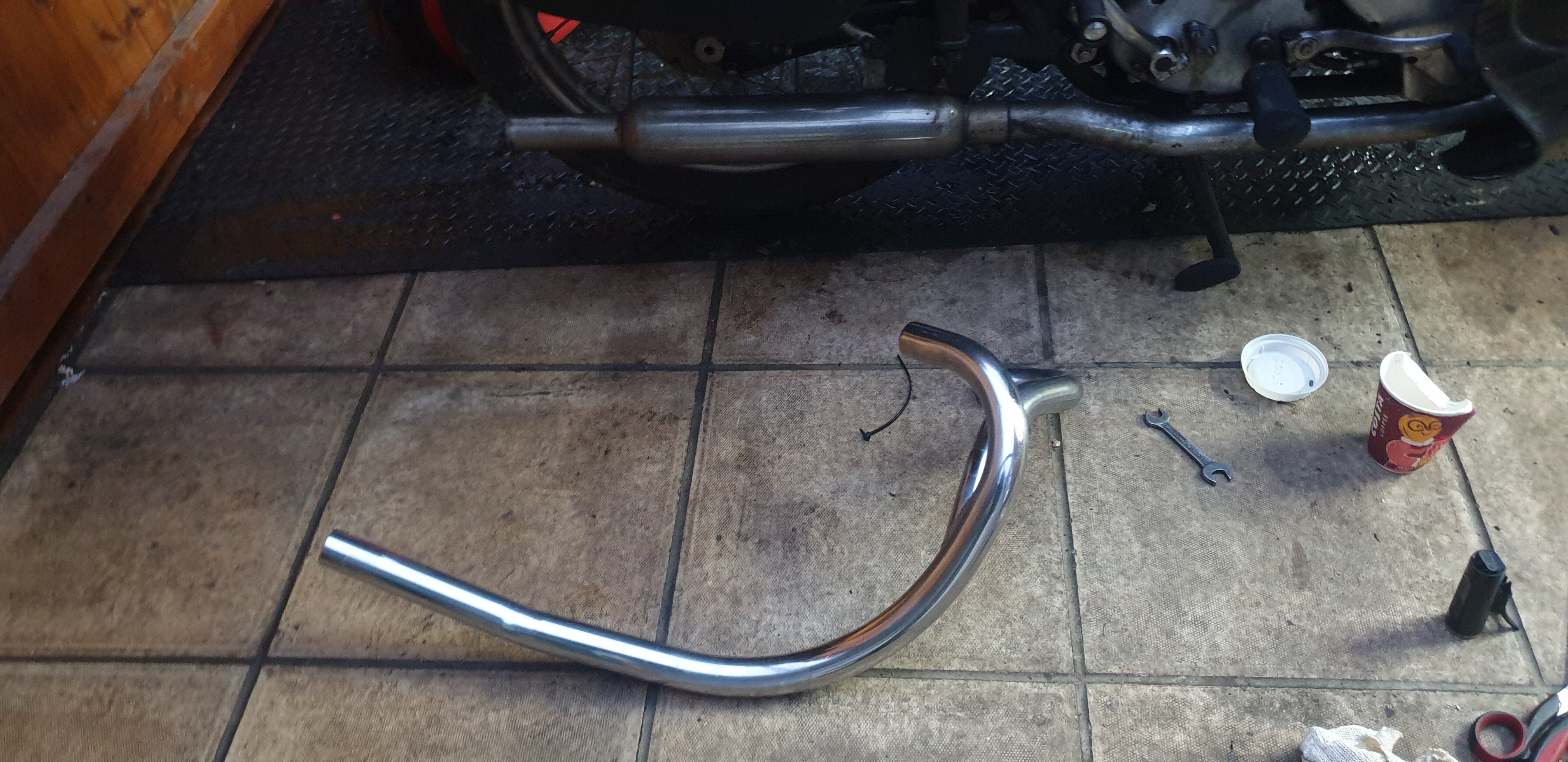

My nice new pipes

That sure looks good pipes!

They are nice pipes. Unfortunately I've an alloy BSA head I've got to get at them with my hacksaw as hey dont have the necessary kink to get around the center stand. So I use a VH silencer and pipe up to just beyond the front fixing into the frame. The smaller dia BSA siamese pipe fits inside the larger VH pipe,
