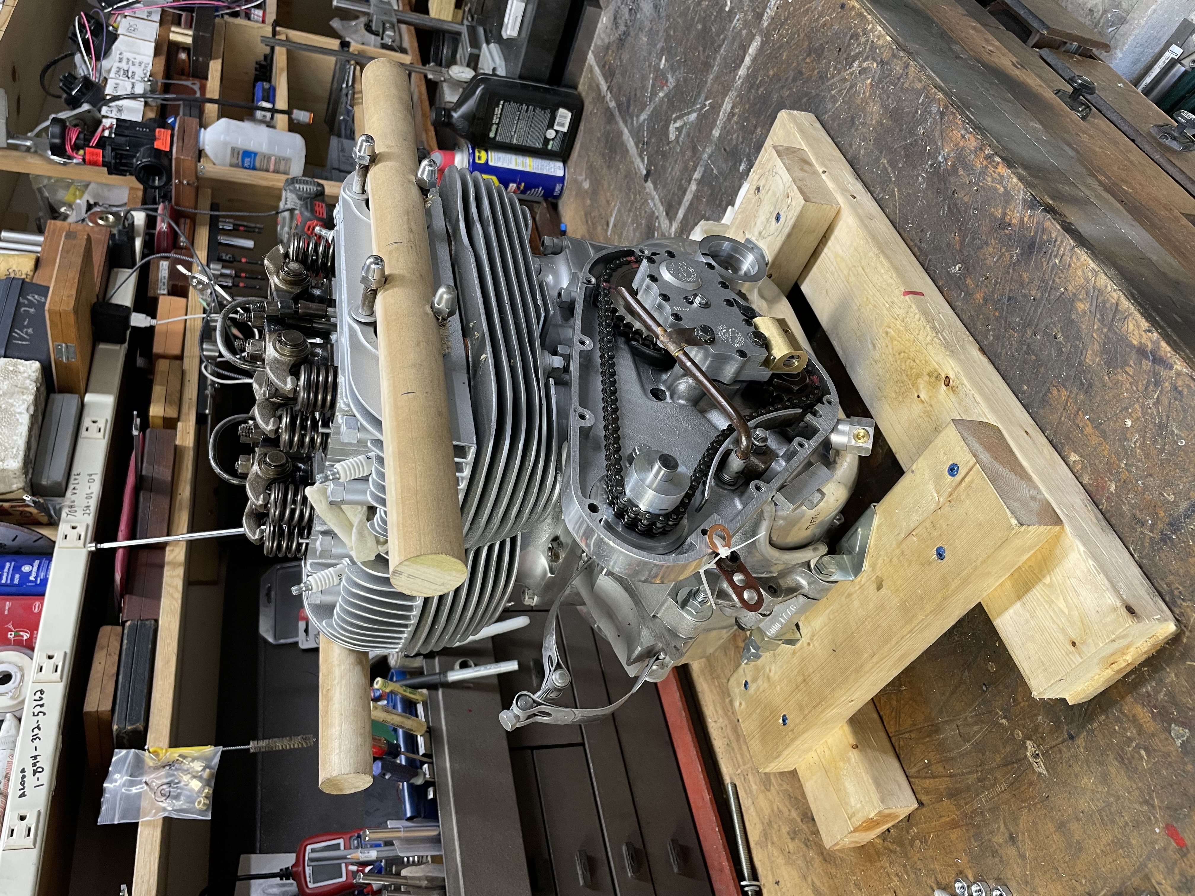

After removing engine for overhaul ( by the manhandling method ) I looked for a more friendly way two people could reinstall it in a more controlled way.This is how we handled the engine and it went in without a hitch.

Lifting by the 'broom handles' will put a lot of strain on the upper exhaust flange studs and risk cracking the rocker box - not something I'd risk.

hi i do not think you will damage the studs or the head flange i lift car engines on the inlet and exhaust studs witch are the same size studs and the engines are a lot heavier for years with no problems :D

I thought the wooden gate handling was pretty a pretty good reply.Thanks for the smile.As for leaping into something without any thought Idont do that.To decide to use the wood dowel rod to aid in engine install I studied the head around top exhaust studs that would carry the weight.Plenty of meat there to carry 25 lbs (11.34 kg )Engine total weight as installed was 104 lbs. (47 kg ) divided by 4 = 25 lbs or 11.34 kg.I would be willing to bet one stud would handle 104 lbs by itself.
