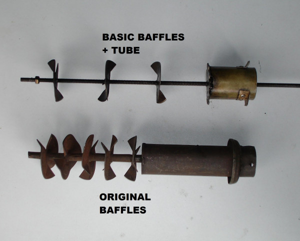

Just for information. Picture of the original baffles and some Armours ones which have a tube added and a shorter 1'' diameter end tube ( not shown ). They are still a bit louder but not much and on the Leader seem to allow it to pull better in the lower rev range. Brian H.
Posts: 1951
Re: Wanted, silencer baffles
The baffles for pattern silencers are a slightly different diameter and will not fit original silencers. This is because the original imperial size of tube is not available. Draganfly's baffles are made to fit pattern silencers and are quieter than the ones supplied by Armours. They started making these many years ago after several complaints about the noise when using Armour's baffles.
