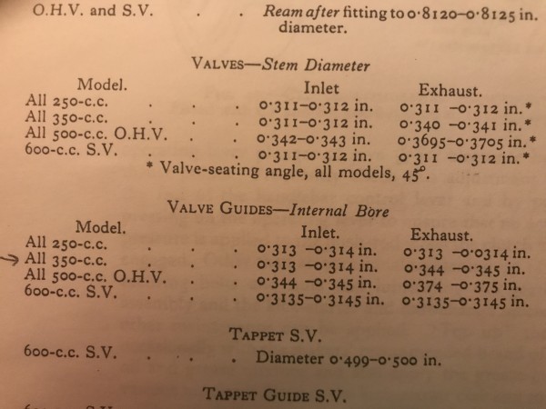

Here are the specs for all singles. Measure your parts to see if your valve to guide clearance is ok. If still under, buy a hand reamer and ream the guides to proper bore.

Thanks,Gui.dorey wrote:Here are the specs for all singles. Measure your parts to see if your valve to guide clearance is ok. If still under, buy a hand reamer and ream the guides to proper bore.
I 100% appreciate your help and looking that up for me.
I have a vernier that I can easily measure the stem diameter, but the bore hole is another story. I might do the wobble method using a dial indicator?
Is it REALLY necessary to have an exact measurement on these? I kind on want to get it together and running, and then get it perfect. Of course i do not want a valve to seize on my first start up.

Re: Fitting new valves and guides
The specs are there for a reason - too tight and they’ll seize, too loose and you’ll get oil flowing into your combustion chamber. And other problems which are just not worth it if you are rebuilding the engine.
The best advice is to take it to a shop. If you can’t or don’t want to, then if you have to invest in the proper tools. To wobble the stems or similar is not a method.
At a pinch, at least try to find a rod or shaft that has an outer diameter within the range of the guide bore and which you can measure with your caliper. Use this as a go no go tool for the guide bore. Not ideal, but it is your bike.
