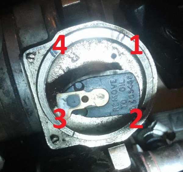

Dear fellow enthusiasts,
Couple of basic questions about square four cylinder firing order:
1. If I am looking at the cylinder block from above, which cylinder is considered the first, second, third, and fourth. Does the first image show it correctly?
2. What is the correct order to connect spark plugs to the magneto distributor? Should the order be same as the cylinder pattern shown in first image?
I appreciate your help.
Kumar

Firing order is correct in both pictures, but that rotor arm looks like it's for the wrong rotation direction.

Hey - the pic of the distributor looks suspiciously mislabeled!
Sit on the bike - twistgrip hand is front pot #1 - number clockwise from there - thus clutch hand is front pot #4.
Pic #1 of the block is correct - Pic #2 is WRONG
The rotor duplicates the pot layout - the contact arm points to the respective pot which is firing.
The flat sector of the distributor body should be across rear of the motorcycle & (approximately) orthogonal to the direction in which the bike is driven.
Cheers, John
Cheers, John

I think it is just a convention that the flat side of the distributor faces the back. The firing order in the distributor is correctly shown in the photo; so as long as the points are just opening for pot 1 which should be at the right spot on its firing stroke, and the rotor arm points to the HT lead that goes to pot 1, then Robert is your mother’s brother.
As Simon correctly pointed out, it is the wrong rotor arm, the brass bit should extend the other way.

On the Sq4 magdyno the flat side of the distributor must face to the left of the machine, n'est-ce pas?Paul_Linden wrote:I think it is just a convention that the flat side of the distributor faces the back.

Actually it doesn’t have to. On mine for some reason, if I do it that way I wasn’t able to get enough movement to set the ignition. In the end I have the flat pointing to 2 O’clock. One can also play with the tooth engagement to have no 1 firing on any of the HT pick ups. Important is that the order 1-4 clockwise is kept. Naturally it makes more sense to have the set to replicate the order of the cylinder barrel, and conventionally the flat should point to the oil tank.chris.shearwood wrote:On the Sq4 magdyno the flat side of the distributor must face to the left of the machine, n'est-ce pas?Paul_Linden wrote:I think it is just a convention that the flat side of the distributor faces the back.
Can’t say why mine didn’t work that way. I just din’t have enough space between oil tank and the Solex bowl to set it that way.

Chris is absolutely correct. On the magdyno Square Fours 1936-48 the distributor base is cast as part of the magdyno end plate and so is completely unable to rotate. The position of the rotor arm can be adjusted instead.
On the Mk I and Mk II models 1949-59 you can rotate the distributor base to almost any angle if you try hard enough.

Sure - maybes you can orientate the distibutor body wherever tickles your fancy...
Such does not alter the fact that when viewed from above; -
the "buisness end" of the rotor arm points to the cylinder which would be sparked.
I believe this to be true for both Mk1 & Mk11 coil ign machines.

I’ve just seen in the picture that this is a mag-dyno square four - so my comment on coil ignition is not really relevant.
