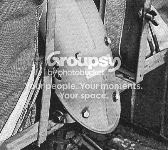

The BSA WD forum is pretty good for this sort of stuff.
I believe it varies.
My understanding is rear of mudguard, just above the hinge, is a favourite place. But I have seen them post pictures with it on the top part of the numberplate (for early bikes when they had them), toolboxes (or wrapped around the mudguard stay on enfields)
Here's a picture of one on the lower part of an Ariel (which is likely going to be covered by your numberplate)
https://s713.photobucket.com/user/rewdc ... 1.png.html

Here's a still from a video from 1944 i posted some time ago. Same as where John has said

TWO W/NGs one of which I still have, have them (originals and matching) positioned on the lower read mudguard. They didn't even bother to get the holes LEVEL when they were drilled. Why would it matter? Be lucky to ever get properly cleaned in service and they were touched up with a bucket of paint and a small broom. By doing it with a rattle can (Matched acrylic lacquer) and a rag over the tire to stop overspray
and sanding the scratch, I'm probably overdoing it..
