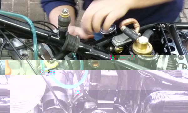

I dont known if its any help but a lot of quick HRD Vincents had them on the tappet covers,they were even made with a boss on to machine yourself,I had a ex sprinter one in the early 80s and that had them on both heads,it had the 2 thin pipes feeding into a catch bottle.I used to empty it about once a month.

How about fitting one of these, and a 1/4" BSP spigot and a hose. https://racingnorton.co.uk/epages/4c675 ... 0A2/707%22
