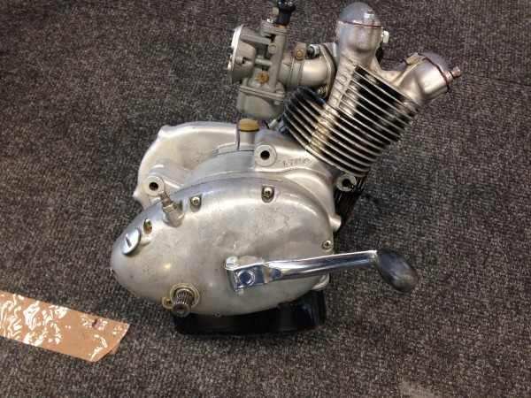

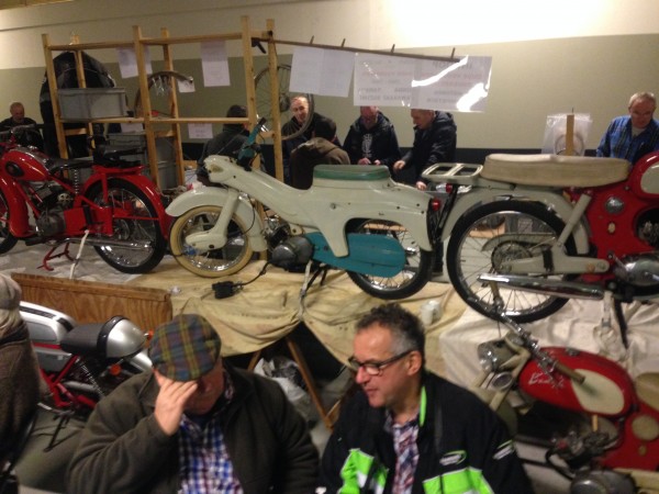

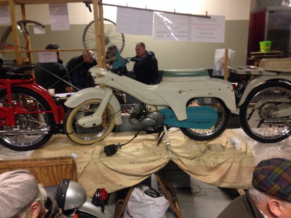

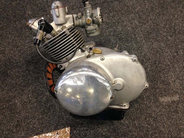

I saw one at the 2018 Rosmalen autojumble and a loose engine at Central Classics in 2017 :
English registration FYX 35???

Re: Pixie
That is a nice little motor, very compact!
