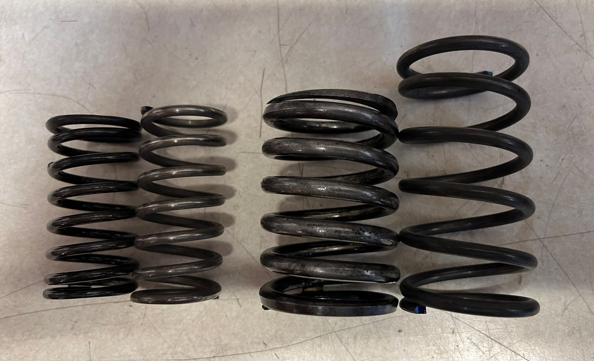

UPDATE: Replaced the valve guides, valve and valve spring was a breeze. I did notice that the comparison between new and old valve springs was significant. I reassembled the head, adjusted the valve clearance and had it running again. Satisfied with how it sounded, my plan was to go for a ride the following morning. I could no have asked for a better morning to hit the road, and after an hour, I had ridden 25 miles without a glitch, and reaching top speed of 50 mph. What fun it was. I did however feel as though it vibrated quiet a bit, especially at higher RPM's.

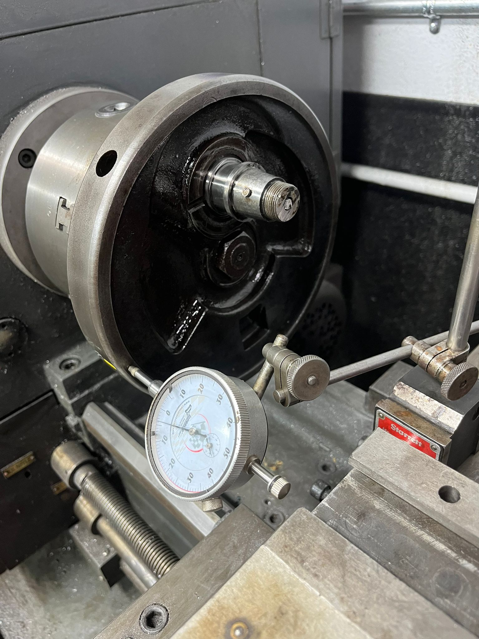

UPDATE: Not satisfied with my vibration issue, I decided to proactively record the crankshaft measurements to make sure all was in order.
Crank in lathe
Crank in lathe
What I discovered shocked me, and now I'm convinced this is my problem since it is so bad
TIR Measurements
TIR Measurements

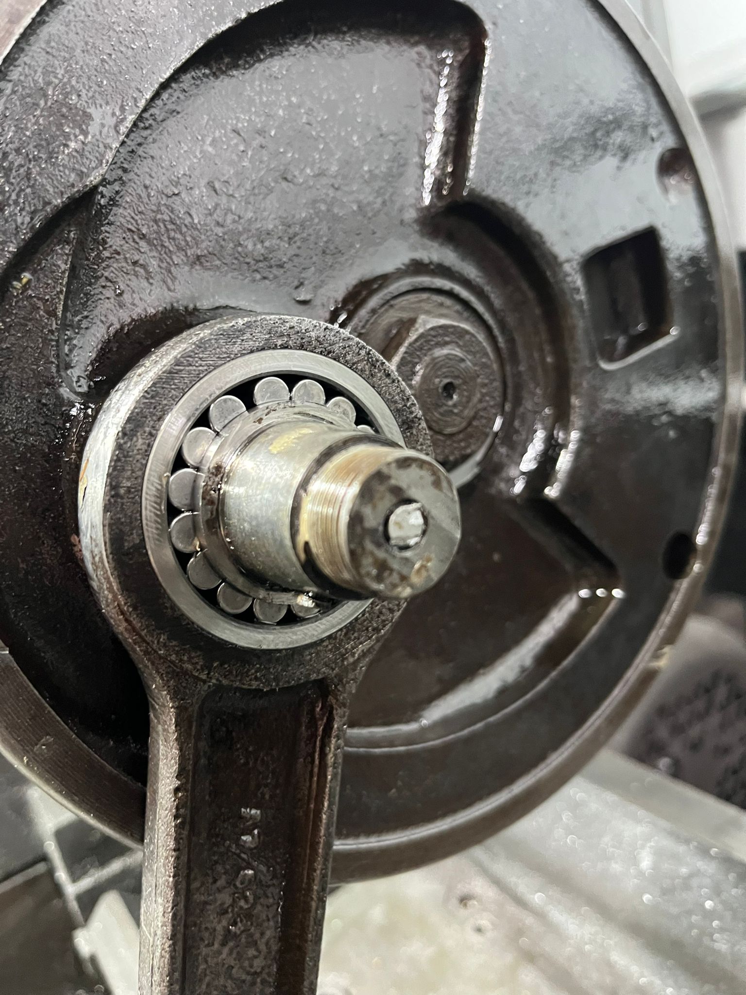

. I split the crankshaft using a short jack bolt & nut and discovered a brand new big-end assembly, then removed the Drive and gear shafts from each of the flywheel halves to clean up the mating surfaces.
Ordered a few new 11/16" x 20 LH & RH Shaft nuts and locating pins from Dragonfly. Be back in a week or so.

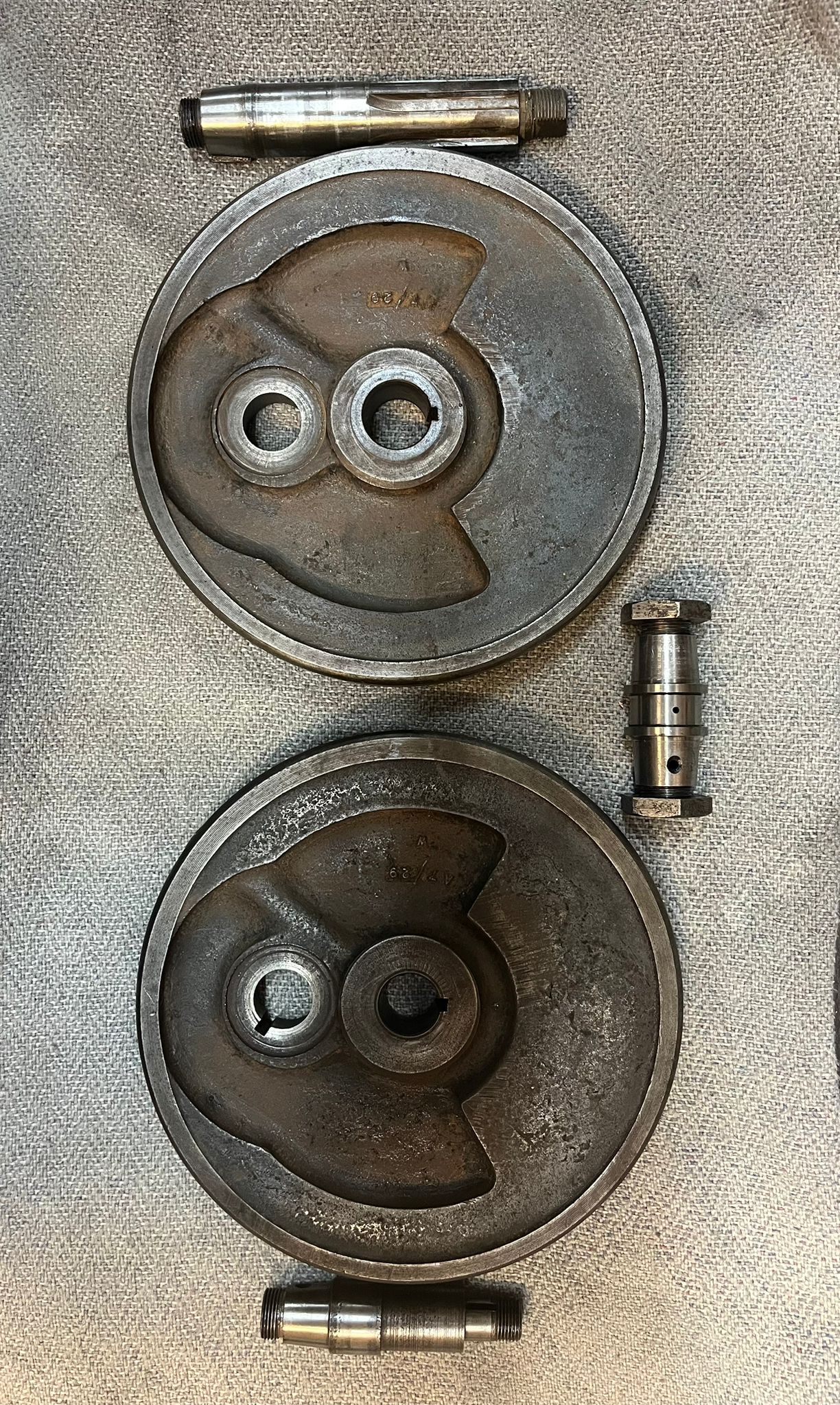

When cleaning the flywheel halves, they both have the same casting number A7/29. Referencing Roger's Knowledgebase article, they are both from 31-32, SB/VB. There are no listed numbers for a 36-50 VG.
Anyone know what the differences were?

1946 VG 500
Posts: 2098
Re: 1946 VH 500 Restoration
The VG should have A7/356 and A7/564. These early flywheels are surprisingly common but properly set up should be smooth as they are plenty heavy. How true does your chuck run as 3 jaws are not usually true enough for crank checking? I suggest trying again but between centres, as long as the centres in the shafts are good of course.

Roger Gwynn wrote: Wed Feb 12, 2025 12:02 pm The VG should have A7/356 and A7/564. These early flywheels are surprisingly common but properly set up should be smooth as they are plenty heavy. How true does your chuck run as 3 jaws are not usually true enough for crank checking? I suggest trying again but between centres, as long as the centres in the shafts are good of course.
Thanks Roger. Any idea what the weight difference is between the A7/564 - A7/356 and my a 7/29's please?

I am afraid not, i have collected a few weights but that would be a long and exhausting survey, I mean have you seen how many there are?
A7/356 is 10-3/4 lbs at least that is what has been written in pencil on the drawing. You have A7/29 perhaps let us know what they weigh?

Roger Gwynn wrote: Wed Feb 12, 2025 11:15 pm I am afraid not, i have collected a few weights but that would be a long and exhausting survey, I mean have you seen how many there are?
Here are the weights of the pieces.
A7/29 Flywheel Weight

Excellent, will add to the list. So the correct flywheels are slightly heavier by roughly 200 gms each. Flywheel weights did tend to increase with the years, as do most of us.
