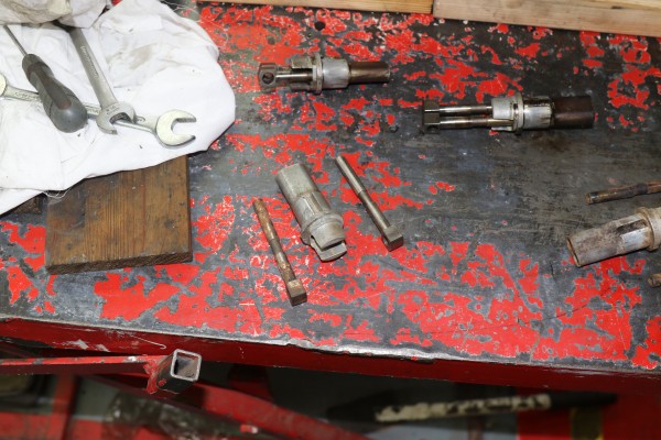

I have been stripping further this week. The cam followers were stuck in the tappet block but have come out with a bit of heat and encouragement and are cleaning up well.

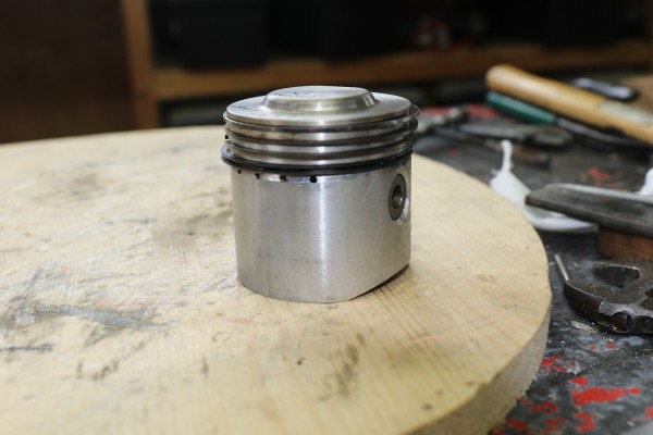

The piston is as it came out of the engine - again, 100 miles to its credit.

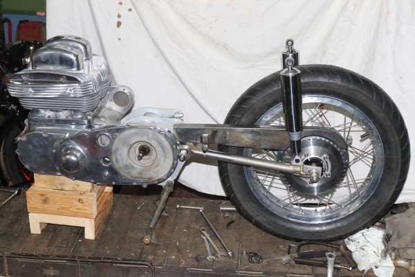

Progress is slow, but it is progress. The back wheel is done and the gearbox is restored. The engine is well on its way but there is still plenty to do there. Stand, swinging arm and chainguard will shortly go to the platers. I need to make a longer brake anchor bar and both swinging arm and rear wheel spindles are temporary, although I do have the final articles now, courtesy of Acme Stainless.
As I keep saying, don't expect early completion, but it is looking better than it did in Florida.

Won't be long until it looks like this then :lol:
Eero.Korhonen
Posts: 1054
Location: Oulu, Finland
Re: The new Project
Post by Eero.Korhonen »
That is like a new!
Br, Eero
