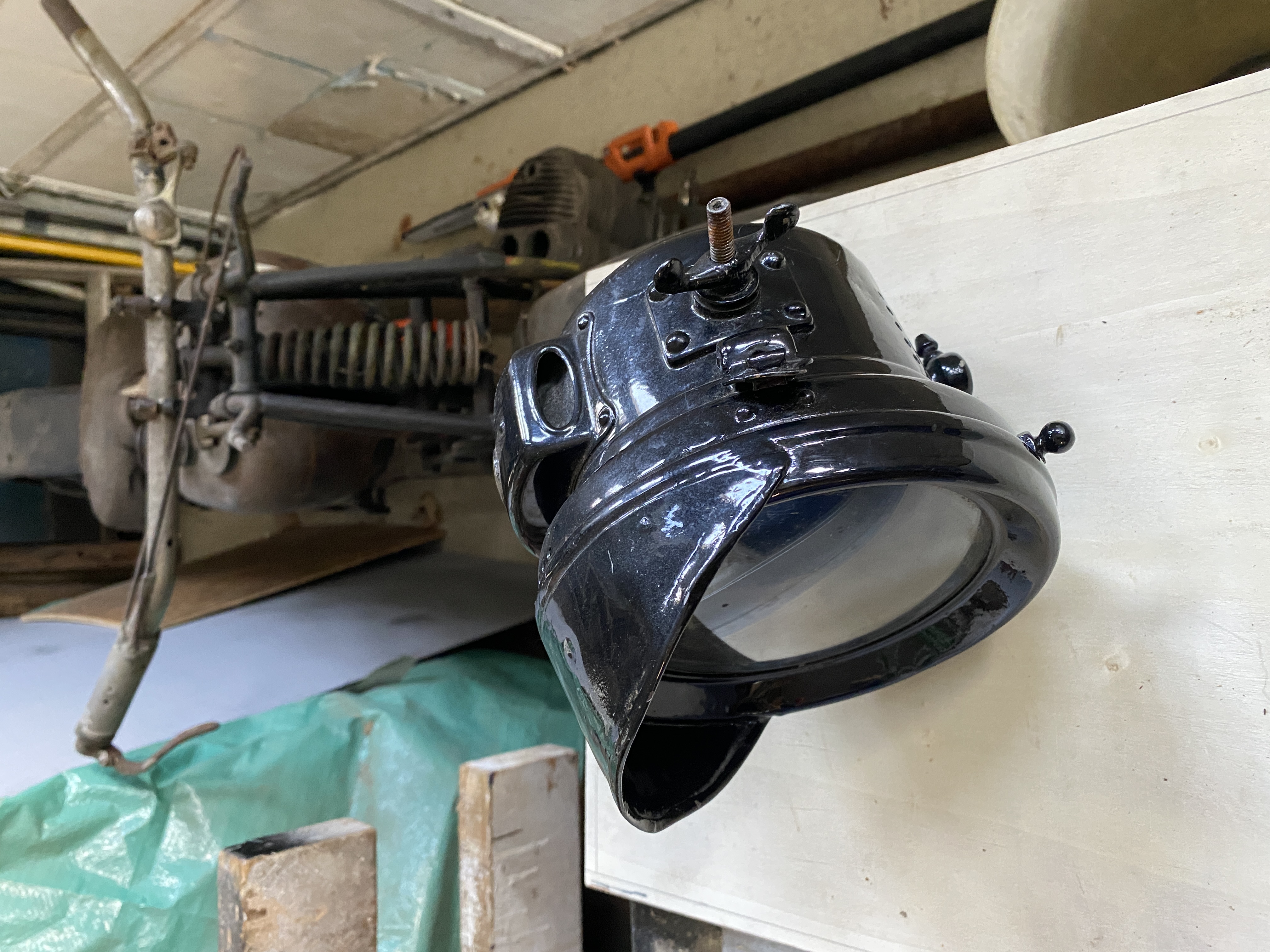

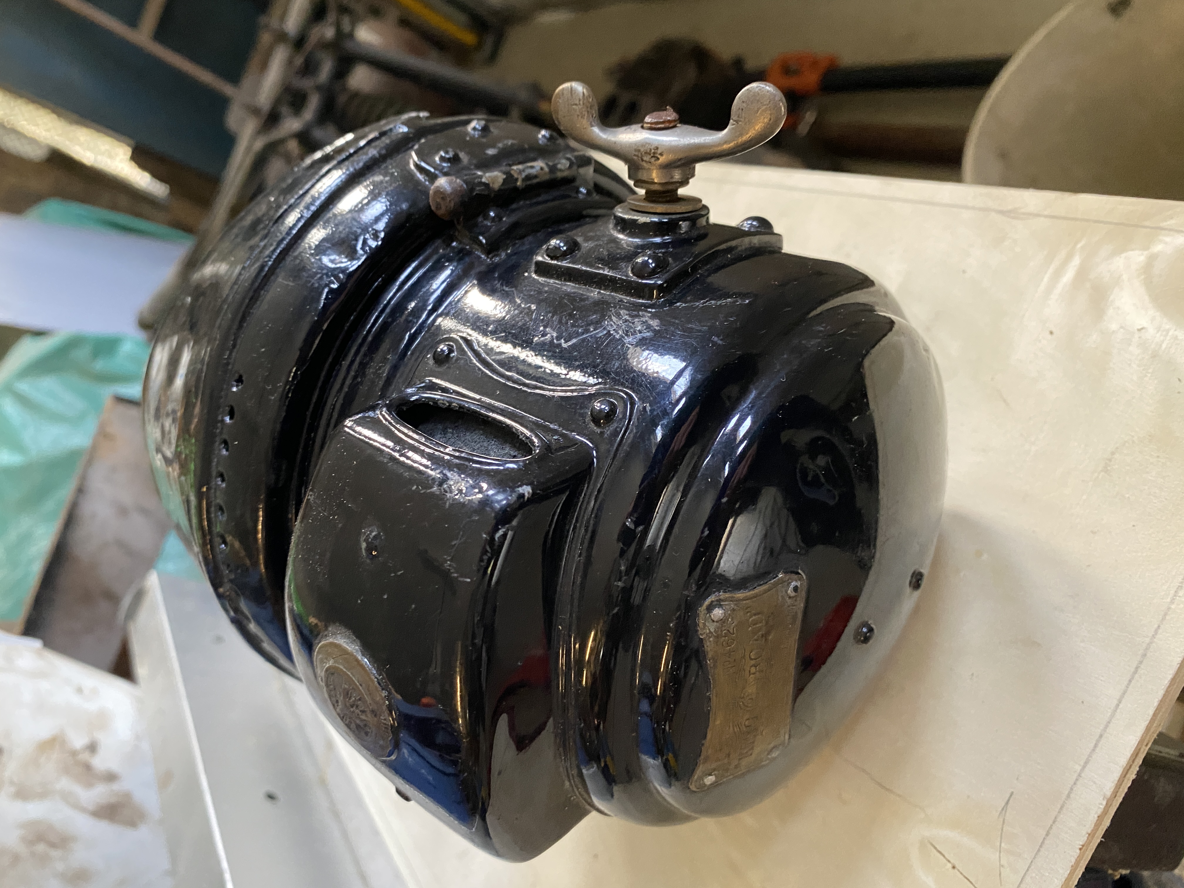

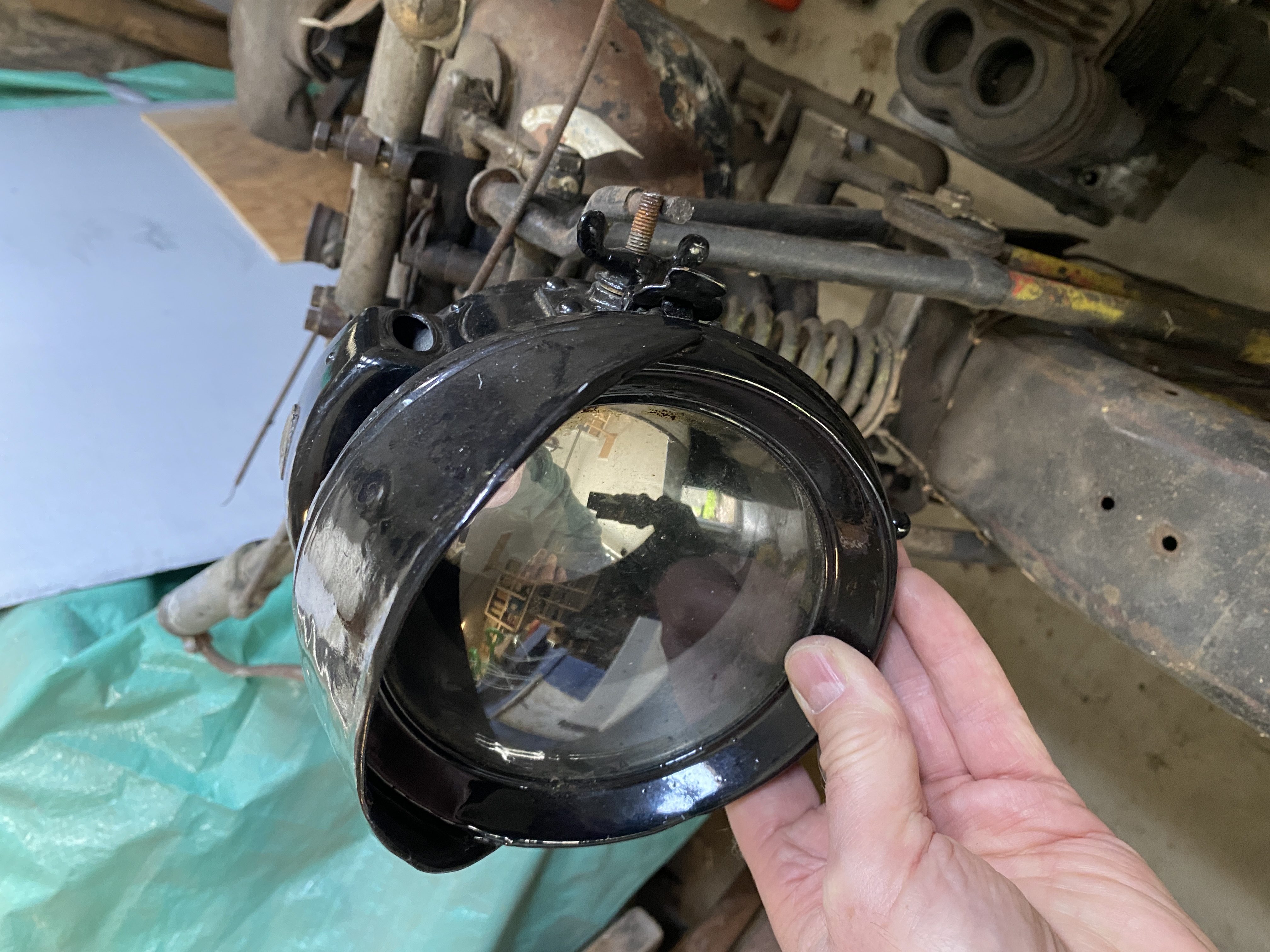

What do you know? I found a Lucas carbide headlamp and acetylene generator. Turns out the first person I asked had one laying around. It is not in perfect shape, but a bit of tinsmithing and a coat of nickel on the appropriate parts and it should scrub up a treat. Unfortunately, he did not have a matching rear lamp so if I can't find one I will probably make up a 'reasonable faximile' to complete the set on my '28 Model B project. As previously stated the system will get LED lights in place of combustable gasses and enclosed flames.

Although often polished or plated these days they were generally finished in best black enamel originally.

I will try to resist 'blinging it up' too much :lol: . Assuming it is not in too awful bad shape once the layers of paint come off, nickel plating the hinged front section is likely as far as I'll go.

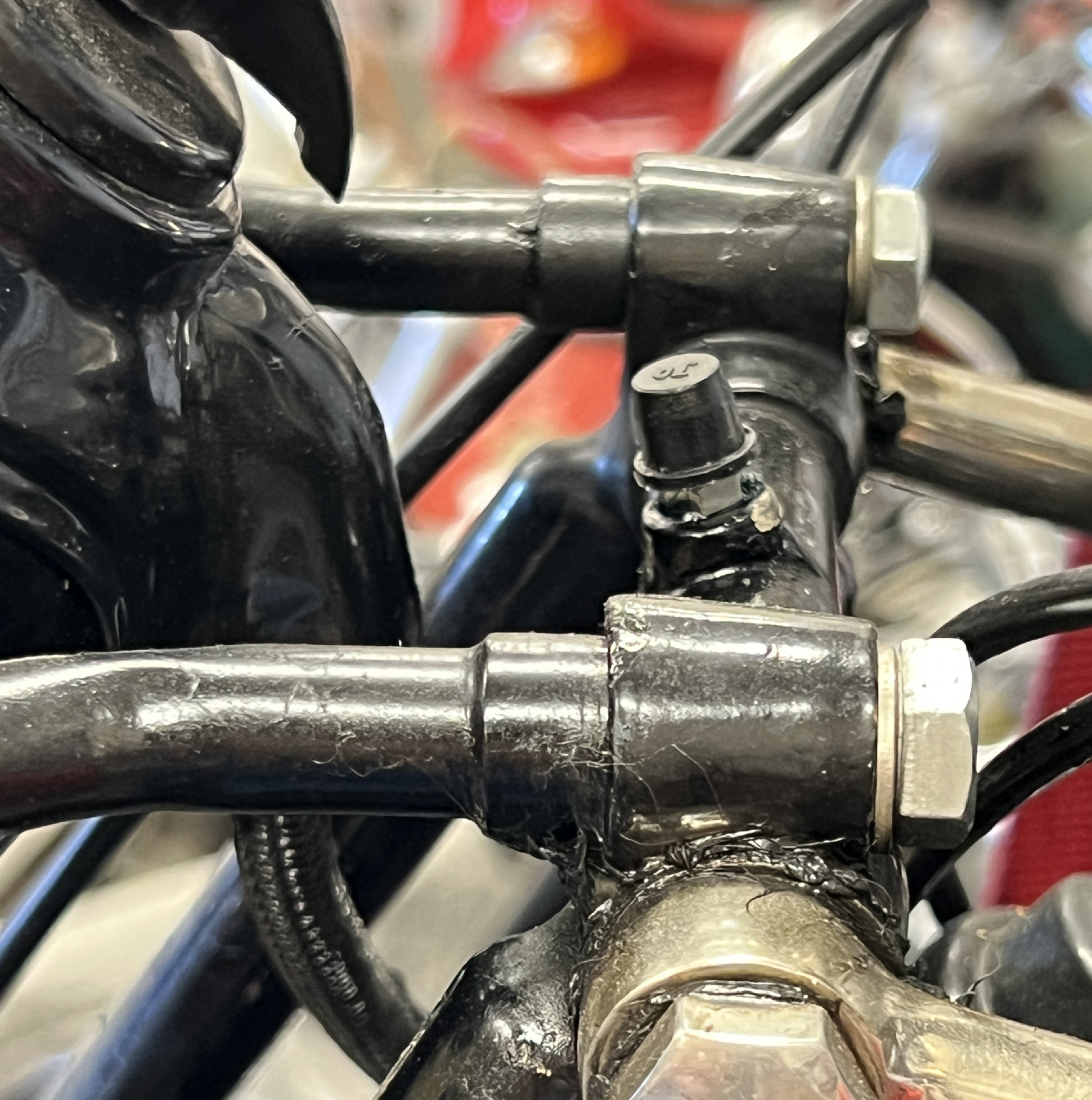

No one seems to have mentioned how the brackets mount to the forks. My 1928 forks have tapered lugs for mounting the brackets and, since my Ariel came to me without the brackets, I had to make my own.
To make the brackets I first had to determine the internal taper of the lugs. After trying 5.7° (1:10), I then made tapers of 5°, 4.5°, and 4° on the end of sacrificial Al rods. Overall, I found 5° was the best fit to the slightly different tapers in the two lugs.
