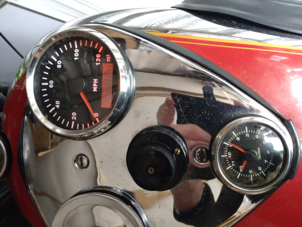

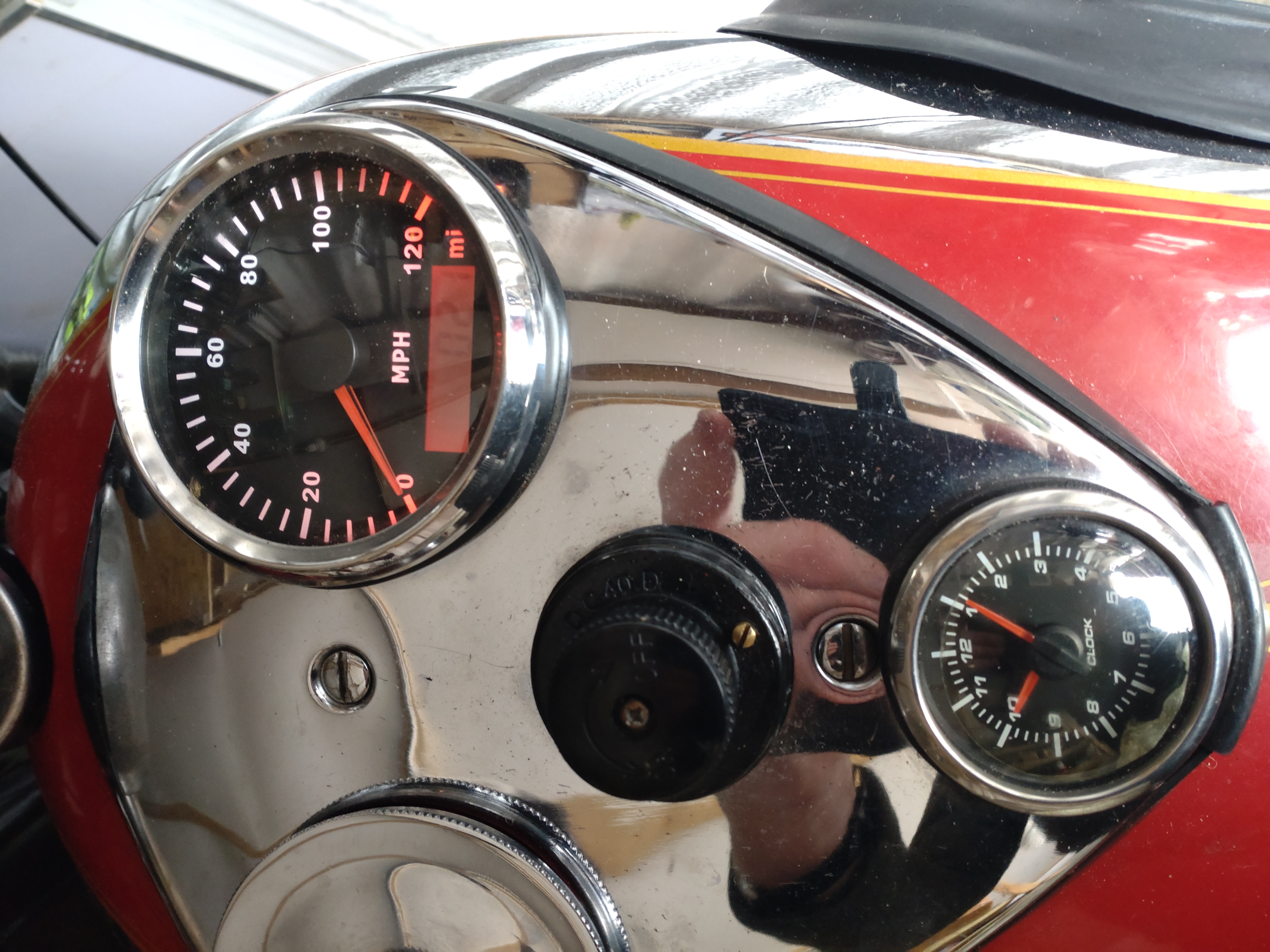

I had the same issue when I was building my 1948VH with a panel tank. I found a waterproof GPS speedometer on ebay intended for motorcycles and boats costing about £35-. The diameter is 85mm which is slightly bigger than the hole in the panel but easily remedied. The unit stands proud of the tank by about 8mm but I sorted that out by fitting a black wrist band under the bezel to raise it up slightly above the surface of the panel.
It works well and is very accurate. On start up after being in the garage the gps takes up to a minute or so to get a fix but for the rest of the day is almost instantaneous. I wired the backlight into the tail light circuit so that it lights up red at night. It's obviously not original, but it is functional and fills the hole in the panel very nicely.
