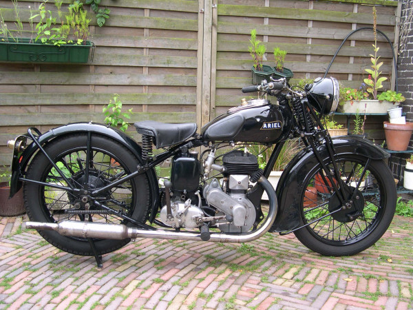

This is my former Ariel, A 557cc 1933 VA-3. It was fitted with a 600 VB barrel, so the piston stopped 3.5 mm (!!) before TDC due to the different stroke of a 557cc sidevalve. (95mm in stead of 102mm) The bike drove like a dream, and reached 90-100kmh with no problem at all... :D
Posts: 4832
Re: VB headgasket thickness ?
Really nice Ariel Paul, mine should become looking similar I hope ! :D
