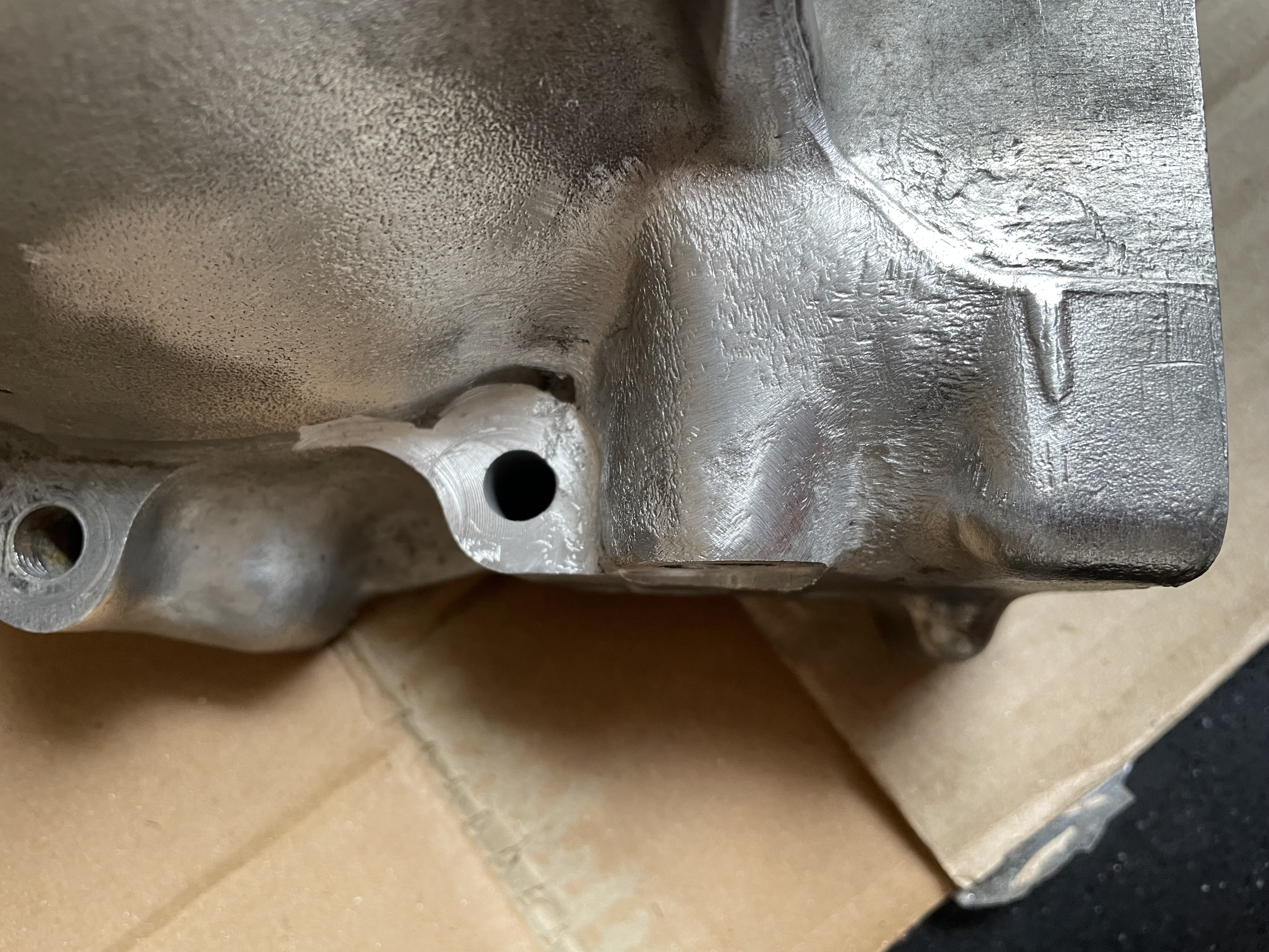

Well I’d delayed sending off the cases due to being busy with life in general, I finally sent them off last week to the welder. Imagine my surprise when I got a message on Monday to say they were done and they arrived back through the door this morning. That’s a one week lead time and a cracking job, costing about £180 including two way postage.
I’m highly impressed and would recommend ‘bad foot customs’ (Russell Bratt) to anyone.

Looks good.
Will you re-tap the thread?

I don’t need to, he did that too!

hi rob he looks very handy to know he done a very good job i would add him to the suppliers list on the forum for other members of the forum to use

The NAME would put you off but the JOB looks fine. Nev
