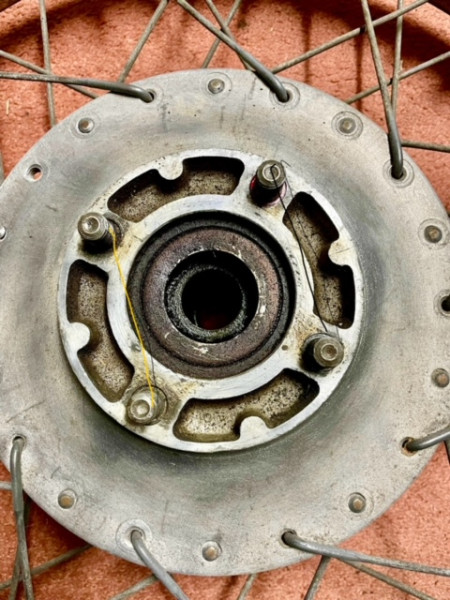

The stud spacing is 2 and 5/8" centre to centre (see yellow line). The studs protrude about 1/2" from the hub. Not sure what the thread is but I bought nuts 42-6095 and they fit.

That certainly looks 'Proper'.
I can't get to a wheel to measure for a little while. Hopefully another user may
be able to oblige . . .
If you go onto the Members Only part of the club website and then the Detailed Images
page of the Pictures section you will find over 400 images of an HS 500. The back
wheel is the same as yours should be except for the rim.

The studs are on a 3-3/4 pcd that means as you have measured they should be 2.652" apart, so you were only .027 out. The hub is certainly correct. The thread is 7/16 BSF and Whit into the hub, one of the rare occasions that Ariel used BSF. There are 2 drawings of the sprocket on file, the first shows one with cut outs and was used until replaced by issue 7 that we also have and shows a solid disc. Issue 6 is dated 29/11/55 so the change to solid took place sometime later than this, the later drawing is dated June 1958, which seems a bit late and could just be the date of the drawing. Incidentally there are 2 numbers on the drawings, the 2nd one has an A suffix and indicates that it should be enamelled when used with a chain guard, no enamelling when enclosed in a FERC. It is nice to learn something new about Ariel everyday!

Thanks everyone. I am now more confident that the hub is correct and the sprocket I have is wrong. I will find a correct sprocket i.e. 47 teeth, flat and with cut outs. I see that Drags have new ones for sale.
