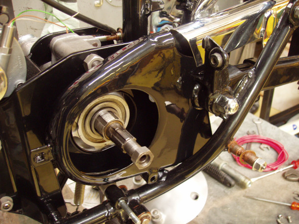

- Posts: 4839
Re: wanted
Combining the front part from a FERC with the 'normal' chainguard does not work straight away.
There is no cast-on ridge on the rear of the later primary chaincase.
But you need something to keep the muck from reaching the underside of the tank and in severe cases your nostrils .
Picture above shows that the rear chainguard interferes with the FERC front part and that the lug on swingarm does not reach the guard bracket.
Picture below : re-dressing the FERC front part in such a way that the rear chainguard has freedom of movement.
- Posts: 4839
Re: wanted
with hindsight, I would now fit the earlier rear part from the primary chaincase and combine it with the top rear chainguard and the 1954 type lower chainguard. that 1954 lower chainguard also has a small screen attached covering the tire.
Using top and bottom chainguards is a must if you want your rear chain lasting any lenght of time.
Spray combined with muck flying from the rear tire at that spot is comparable with putting the chain in a blasting cabinet !
'54 bits look like this :
