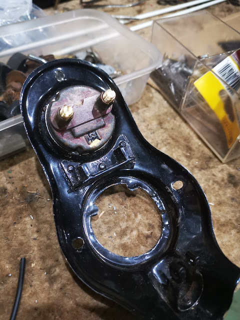

A couple more useful pictures

Yes that looks like mine (or at least the subpanel shape looks correct. On mine it doesn't look like a separate panel but, like you say, it might have been painted fully assembled. I'd like to keep it that way without breaking the paint so might be a bit fiddly to sort out. Not sure if my ammeter is 6v or 12v but I'll take it out of circuit and just connect a multimeter into the circuit and it'll tell me what's going on when I put a load on the circuit or start the bike. What's the ideal charging voltage for a 6v system? I can put a power supply onto the bike ammeter to see if it works under 6volt and if not I'll try it on 12v. I'll just put a couple of Amps through it. I should be able to do that with the ammeter in situ if I rig up some leads for the regulated power supply. The link looks quite useful. I suspect one of those wiring diagrams is the right one for my bike.simon.holyfield wrote: Mon Oct 09, 2023 12:16 pm
Here you go. That's a repro ammeter - original ones don't have the clamp bracket, but are retained by tabs on the rim as has been said.
Ian

I can confirm that the ammeter is the peened over tab type so I'd rather leave it in place (disconnect one side and put a test meter across to see what's going on) and test it in situ until I can confirm it is actually dead or wrong type. Looking at the circuit diagrams you linked to and, if I'm understanding it, the fact I'm seeing more than battery voltage at the battery means the regulator is working and passing a charging current across the ammeter without the needle deflecting. Without the ammeter in circuit the regulator wouldn't charge the battery. Does that sound right?
The only question now is what is a reasonable charging voltage I should see at the battery, so I know I'm not cooking the brand new one I've just bought? The old one must have failed for a reason (hopefully lack of use and not overcharging). So as long as it's a reasonable charging voltage the lack of functioning ammeter isn't an urgent issue and I'll just keep an eye on the battery until I can sort it out.

Charging voltage should be around 7.2, but you might need to rev the engine a bit to see it.
Couple of other points - my bikes all have LED lights. The ammeter may not move much, depending on its measuring range (normally 8-0-8). Secondly, if the battery is fully charged, the ammeter won't move much, or at all.

Another useful link there Steve. Yep mine's an 8-0-8 Simes. Thanks everyone. I'm on it.

If there's nothing obvious when you look at the wiring I'd start by checking out the ammeter. Disconnect the wires from the terminal post, (making a note of where they are fitted), and tape the ends to avoid accidental contact / arcing. Place the probes from a multimeter, set to resistance on the terminals and observe the reading. If you see a reading of a few ohms the ammeter is probably OK internally, if you see 0 ohms, (open circuit), the ammeter is broken and if you don't think you can repair it, should be replaced. You might like to leave the old one in place until you can temporarily fit a replacement into the loom to confirm you've fixed the issue
If there is continuity at the ammeter, (indicated by a low ohms reading), make a simple test circuit - run a wire from the battery to a head or tail light bulb, from the bulb to the ammeter and from the ammeter back to the battery, the bulb should illuminate and the ammeter needle show a deflection. If you see a deflection swap the wires at the ammeter terminals and the deflection should reverse. This indicates that the ammeter is not at fault and it's time to investigate the wiring and components in the associated circuit. If there's no deflection it's most likely the needle mechanism is seized, get a new ammeter.
Regards Mick
Regards Mick
- Bob.Murphy
- Posts: 1216
Re: Ammeter not reading.
Err, ammeters should have negligible resistance - they pass the current straight through. Voltmeters should have infinite resistance.
