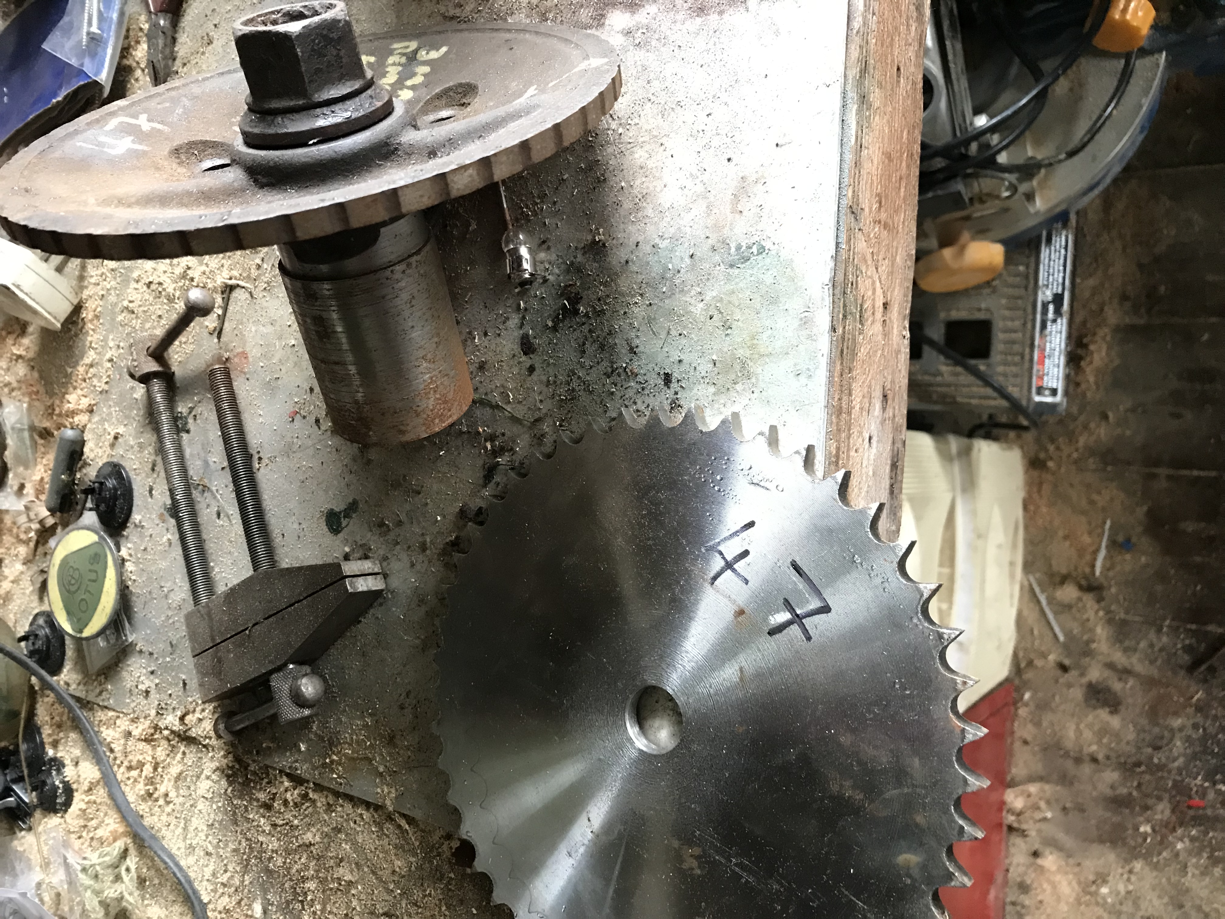

In the sixties there was a company producing an alloy sprocket carrier, When I contacted them, 1972 ish they had ceased production but sold me a couple of raw castings & the drawings - perhaps they are out there somewhere !
There were also firms who could reclaim sprockets ( at the cost of 1 tooth) so perhaps that is how there are some non-standard sprockets about !
More recently (in the absence of a casting) I have machined a sprocket carrier from aluminium billet.

You can buy platewheel sprockets of the size you want to fit to an old cast iron carrier which can then be either bolted or welded together.
