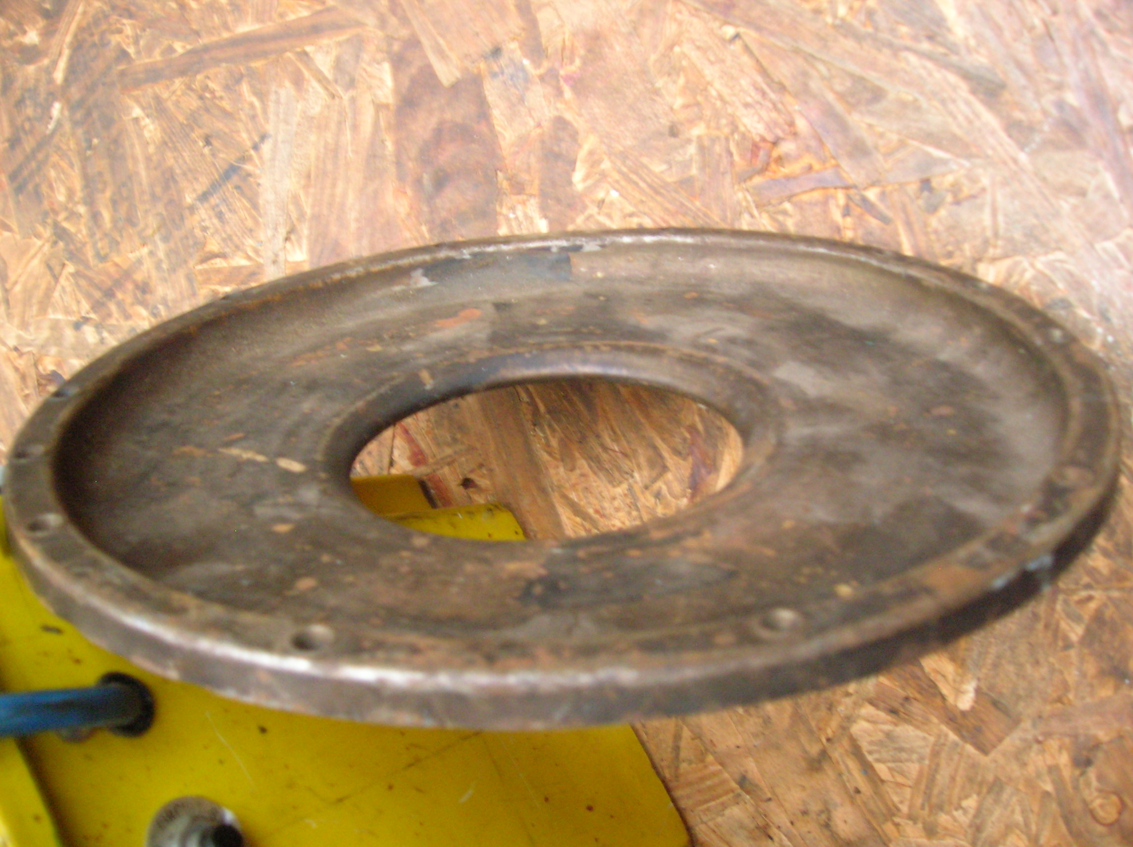

Hi Steve, what I have.....only the rim.
like all Ariel clutch dome things it's a oval shape
pretty hard to get remade . see those welded in small nuts

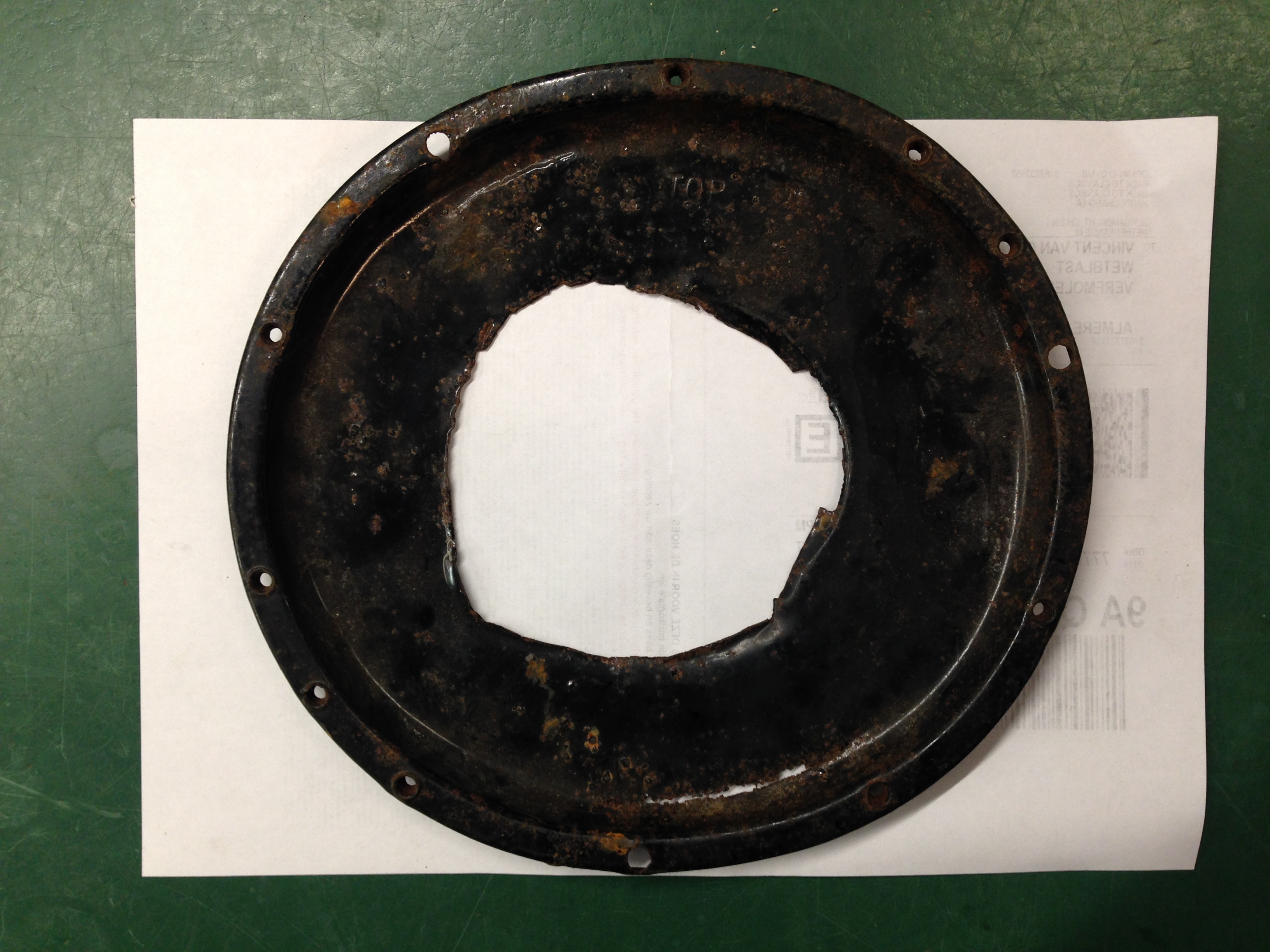

I have another one that is only slightly better, it also has the flat part cut out but not all the way like this one.
the hole for the mainshaft is also oval (edit: sorry it's round
) and has a trumpet shaped rim for keeping the oil in the case.
the other plate I have.

Very helpful pictures Vincent. Nev
