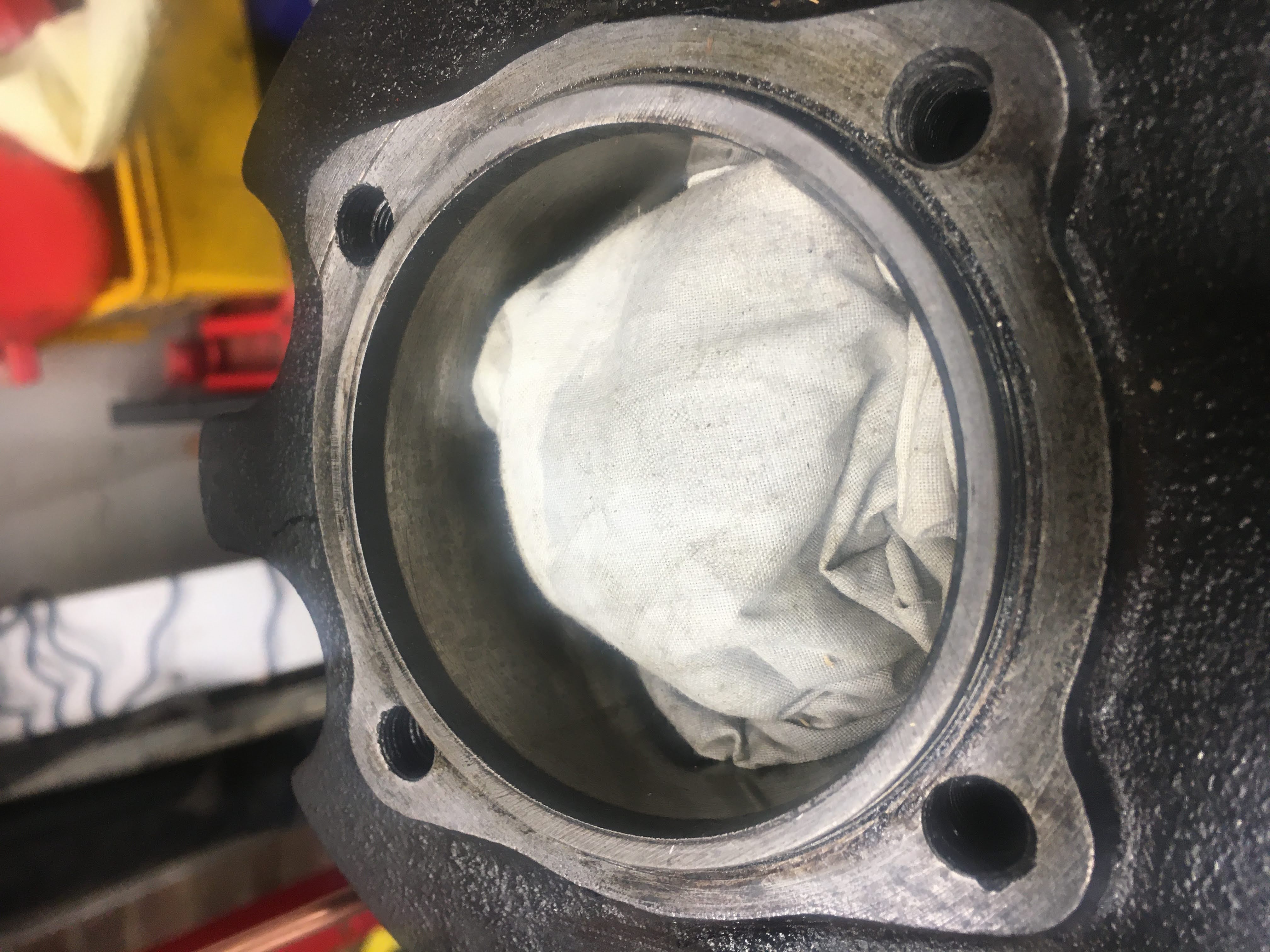

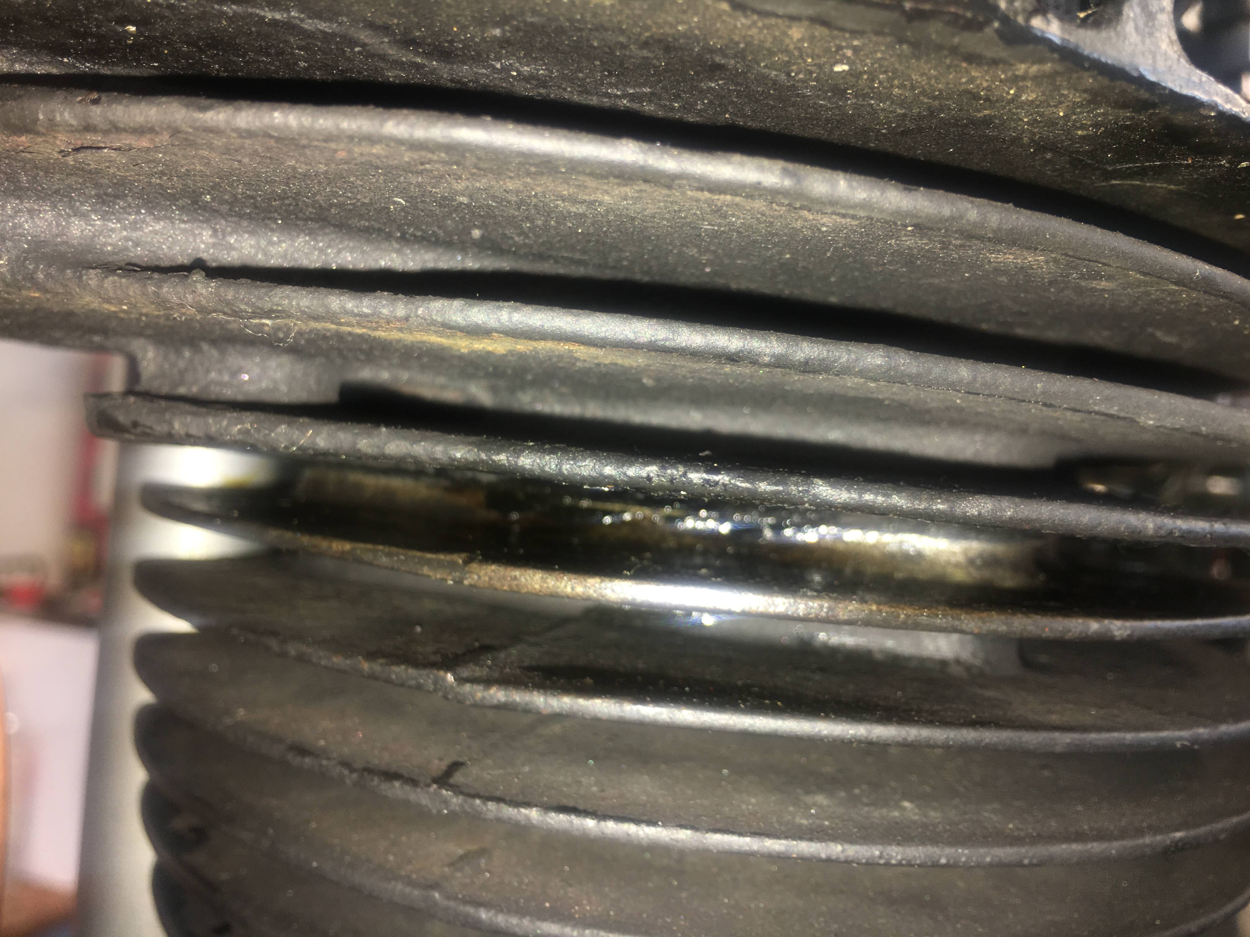

So, I lapped the joint as suggested, however, there is still a very small escape of oil/carbon, between the head and the barrel. The pictures show the head/barrel (before lapping). As you can see, on the bottom of the picture, which is actually the front of the engine, there is some corrosion on the head, but I don't think this is a problem as the seal is not made there, but it is where the leak is.
Is it normal to have a tiny leak?
Any other suggestions?
Thank you
Steve
Thank you
Steve

It rather looks as if the spigot on the barrel still isn't making a good seal in the head,
especially by the pushrod tubes.
With the head sitting on the barrel there should be a noticeable gap between the
surfaces where the head bolts pass through. If there isn't this may be why the
spigot won't seal.

Do you mean when the head is tightened down Will?
- Posts: 1201
Re: cylinder to head mating question - w/ng
With the head just sitting on the barrel - no bolts and no pushrods or pushrod tubes.
