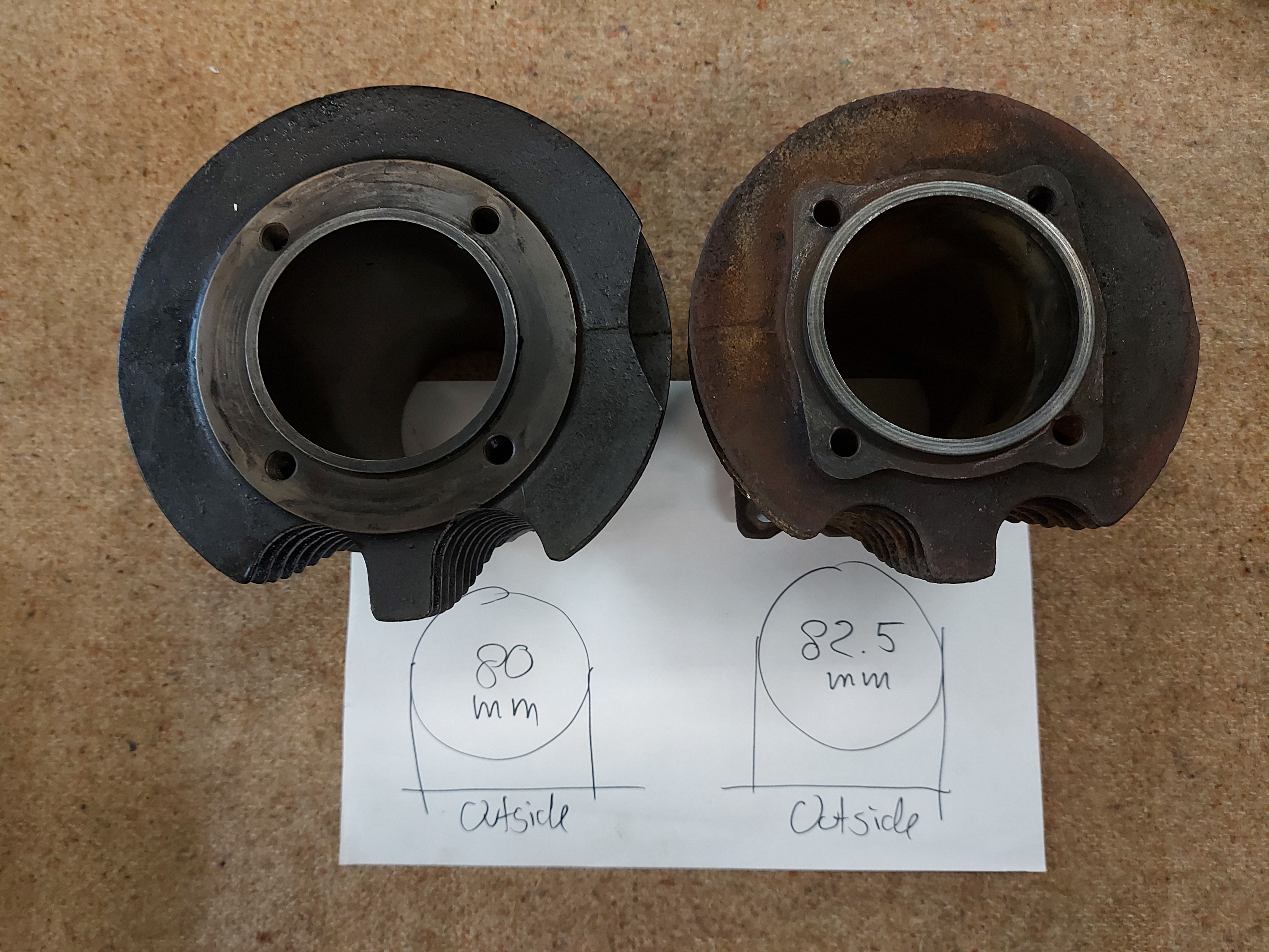

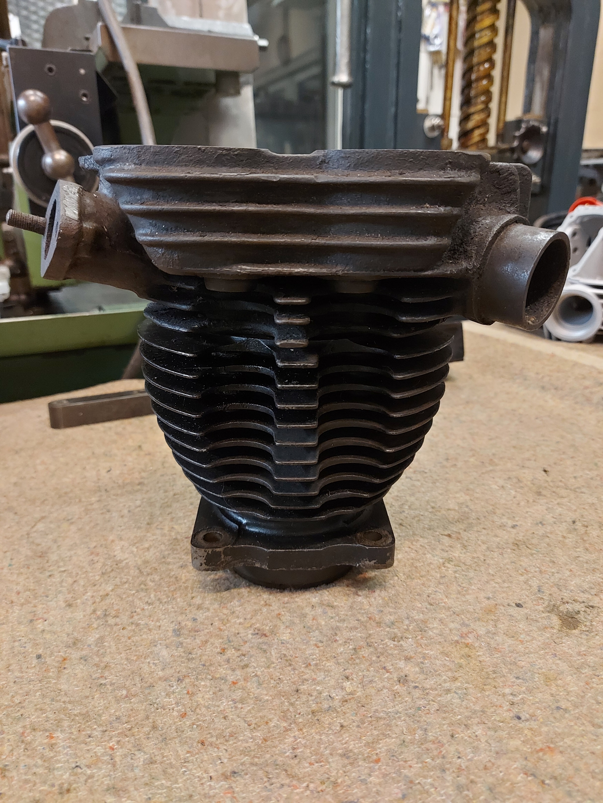

Hello Steve,
you probably have a NH cylinder and a WNG (or NG) head.
see pictures.
NH cylinder has a 'thinner' liner / rim
WNG Cylinder with WNG head :
NH cylinder with WNG head :
as you can see the NH cylinder has larger finning
see pictures.

I looked up your introduction post with the pictures from your WNG and you indeed have a later cylinder

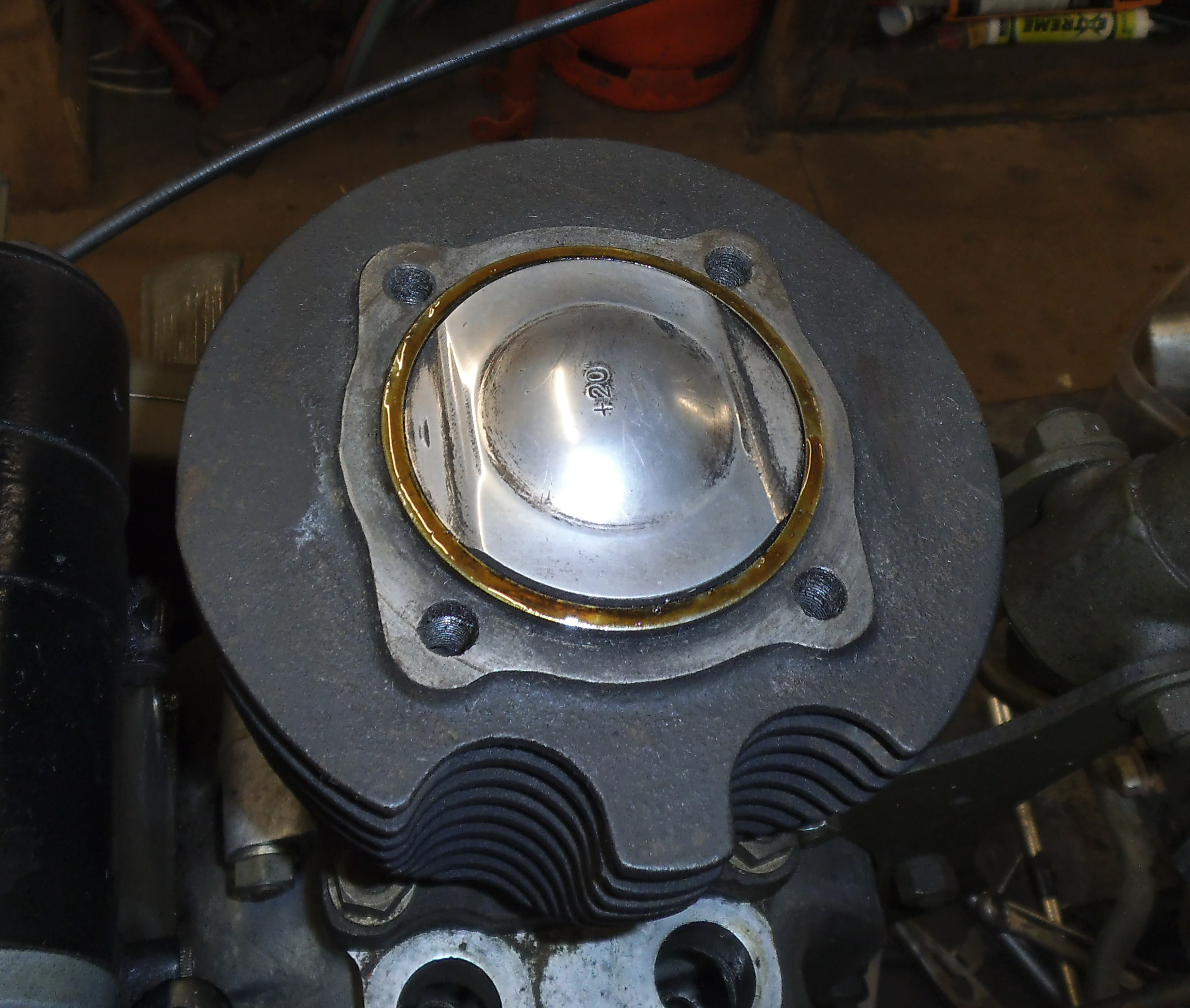

I have found a picture from the previous owner of the top of the cylinder.
The mismatch between parts/models is concerning me, so maybe I can ask for your help with the following:

Hello Steve, your picture does not show the cylinder that is on your WNG right now.
it is a earlier one, WNG or NG.
But that aside, I think you can use the cylinder you have now, it did function before.
Give it a lap and if you really, really want it to look like a WNG cylinder you could take out the angle grinder and slim down the outside

I am very sure it is my cylinder - Ron sold me the bike and it is his picture.
What makes you think otherwise?
