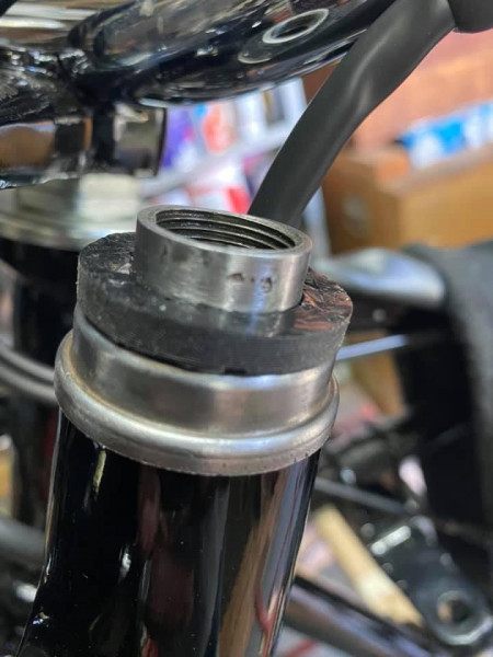

This is my 48 forks.

Not sure but my '54 VH has the top yoke shown in the forks diagram in James' post and the fork top is tapered slightly to fit into the yoke. Unfortunately, I can't provide a photo of the rubber and fork top as it is assembled and they are not on show.
Dennis
