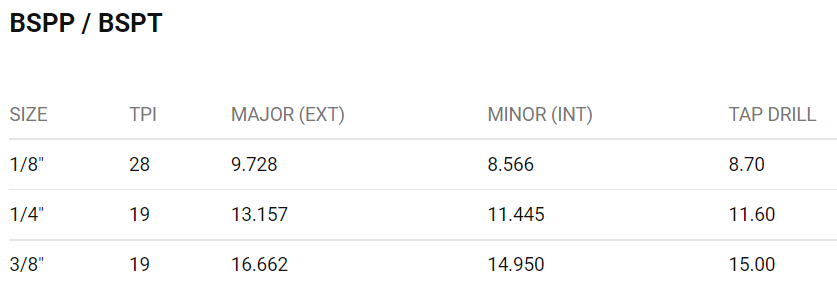

Roderick.Bradley wrote: Sun Jul 24, 2022 9:22 am (The thread on the petrol tap that screws into the petrol tank boss is 1/8 BSP, by the way).
Cough, Cough, Mr Bradley...As said by me, the USUAL thread size on a petrol tap is 1/4 BSP

Yes, Les, you're right. 1/4 BSP is the usual petrol tank tap thread size. But for reasons in the past only to be guessed at, it's a 1/8 BSP in this instance. Not the best size.
I think I will go ahead with tapping the other (filter) end of this petrol tap to 1/4 x40 TPI M. E. to be able to screw in the filter.

Re: Petrol tap gauze filter thread
