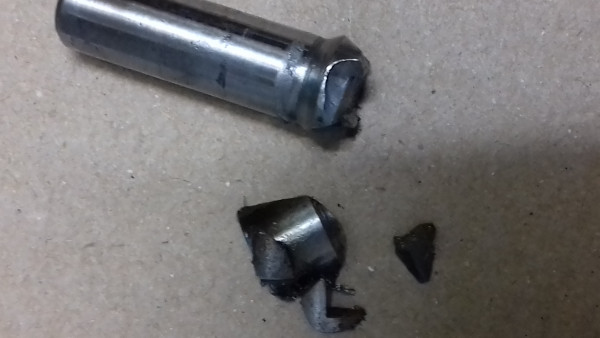

Well its nowhere near as bad as Gui's problem , I took my Mk2 for its first test ride and after 10km I lost drive and no clutch , I felt something go , and coasted to the hard shoulder , the clutch cable was slack and I could move the kick start with no connection to the engine , I removed the clutch cover and the plates were all loose then I realised it was something to do with the clutch pushrod , put it back together and called the ANWB [AA] I was taken home on the back of a heavy goods recovery vehicle , my 10km ride was 4 hours . I removed the gearbox outer cover to discover the clutch operating arm plunger was broken and fusion welded into the mainshaft end it took a lot of hammering to remove it , when I built the box the plunger was a little bit tight and I removed a little bit with emery in the lathe , I realise now I should have paid attention to the mainshaft bore and used a flex-hone on it , I wondered if this is a common occurence or the roughness of the mainshaft bore that caused it , I will now carry a spare plunger with all my other odds and ends just in case when I can get the parts

When I recieved my new GB7 mainshaft I never thought of taking all measurements of it , I believe the broken plunger was caused by the push rod bore size being undersize at 8.56mm and the plunger a tight sliding fit , the original mainshafts push rod bore is 9.10mm , the length from the bearing face to the end of thread on the new shaft is 38.19mm and the original shaft measures 36.82mm , the clutch pushrod is the correct length and I did lubricate the whole assembly , when the clutch lever was pulled in , the plunger was forced against the mainshaft and friction welded itself together.
I am now thinking I will have to strip the box and remove 1.37mm from the kickstart end of the mainshaft , I will enlarge the pushrod bore at the plunger end too , If I am the first one to have this happen in 70 odd years it must be the mainshaft , or am I just Unlucky Dave

Dave you must have had about .054" extra end float on the mainshaft unless all the extra length is thread. As the plungers are 5/16 dia and your hole is 8.56mm there should be enough room. You would have to be holding the clutch in for a long time to friction weld the plunger to the mainshaft as it has to get very hot, like lots hot.

Roger , yes the extra length is thread , I was exagerating a bit with the friction welding , the plunger had picked up and was difficult to remove , I had to use a hammer , luckily I have a suitable Flex-hone to clean up the bore when I recieve a new plunger
