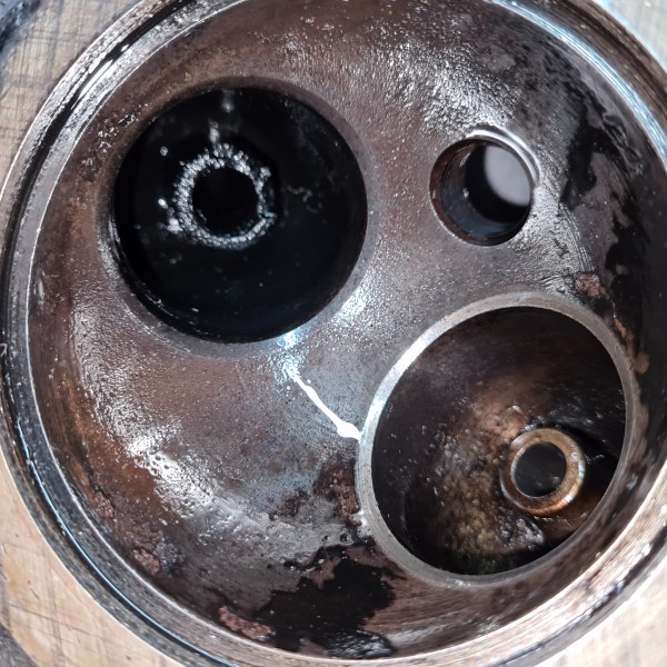

The channel for the exhaust valve on my NH350 is quite badly corroded, as per the pic. Can't see it causing a running problem but is this otherwise normal?

is it corroded or just soot build up?
Try clean it first and check the clearance of the valve stem in the guide.
If o.k. then give the valve a light rub in and put it back together again.

Thanks, the valve clears fine but it looks like the end of the channel has started to flake off, I suppose it could be a lot of soot, didn't want to clean too aggressively in case it is delicate. It seemed to work before so will give it another clean and put back together, thanks again.

First time dismantling a motorcycle engine (initially to change head gasket), and now feel quite foolish as I realise the "channel" I mention is actually the valve guide and not an integral part of the cylinder head. So next stupid question, assuming I can source a new exhaust valve and guide how do you remove the guide? Eg does it pull out from the top (rocker) side or from underneath? Should it push out with a gently tap with a Hanmer and drift?

That's o.k. there was a picture with it !

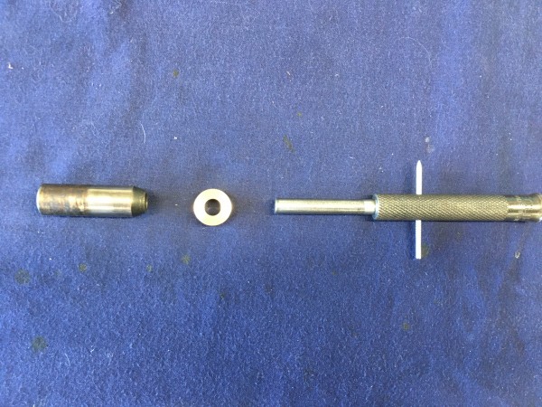

If you are drifting out the guide and you have new ones to insert then here is a little tool I made to assist with this operation on my 1946 VB600 side valve. It will work perfectly for a OHV engine.
I turned down a suitable old drift to fit and removed the chamfered part so it was square. Then made a Bronze collar to fit the shank and sit square to the thicker end. You can use it with out the bronze collar to drift out the guide ( pre Heating the head will assist this) as damage to the old guide is not important. However when drifting in the new one ( pre heat the head again ) you don't want to peen over the top of the guide so using the bronze collar is important. Being softer than the guides damage will only occur on the bronze collar.
The picture shows the component parts. very simple to make. The calibrated pin going though the shank ( actually a nail brad !) is to locate the shown guide to a required depth when drifting it in as there is no ridge to halt the insertion on this guide shown. It is actually from my 1933 Austin 10/4 where I replaced all guides a few weeks ago.
