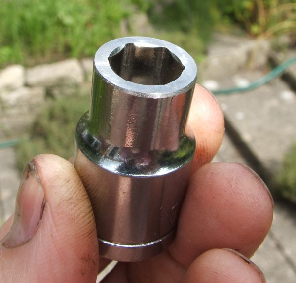

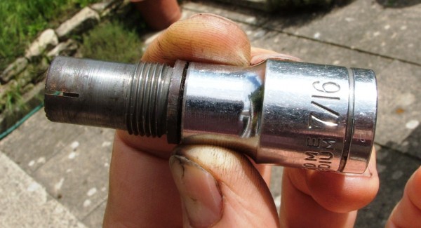

Part of the problem seems to be that many sockets don't go fully onto the sludge trap nut. I use a slim 7/16" six-sided socket with the end ground flat to reduce the internal chamfer. It sits flush to the sludge trap flange and perfectly into the flywheel hole. It has worked successfully for me on several previously user-mangled sludge trap nuts - probably because it engages on the part of the nut not previously reached.
Also, I always use a T-bar to keep the socket square on the nut.

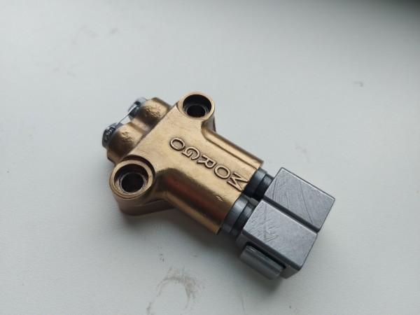

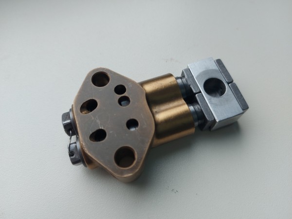

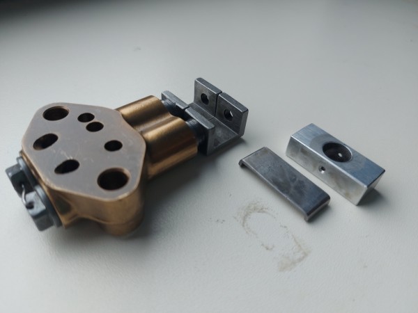

A few years ago (ah, maybe 15-20 or so...) I re-made a Triumph plunger Morgo pump into one to fit a Ariel.
At that time the current Morgo-Ariel plunger pumps where not made yet.
Did not use it afterall as I got wind of what Nev remarked on that the flow would be to large for a ball/roller bearing engine.
So I never really used it as I did not trust it. ( I could have sold it a few times but I did not dare)
It does however pee like a twenty year old into your oiltank!
Pictured below my DIY version of the Triumph-Ariel Morgo pump.
return plunger 12.4mm and delivery plunger 10.6mm
Does anyone on here have one of those 'new' Morgo Ariel plunger pumps to measure the diameter of the plunger to compare ?
I would like to know if this 'new' one has the same dimension plungers as the Triumph one I still have.
Brass pump body is shortened and slimmed on the contact flat. ofcourse plungers are shortened as well.
Behind the sliding block sits a small steel plate, that is needed to bring the sliding block nearer to the excenter on the camshaft.
(slimming the brass body can only be done up to a certain point as you dont want to break into the plunger chambers)
Bottom holes in pump body are elongated to match up with the Ariel holes.
The mounting holes need a small bit of clearing as the Triumph ones are a tiny bit closer together.
