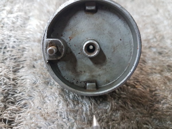

Hi Wade
Pictures of float bowl parts, think that’s what you wanted
Pete

Yes, Pete, that is perfect. Thank you very much for posting :D

How does the bowl cap stay in place? It has no threads to screw into the bowl. It has two alignment nubs that would stop it from turning. I see no evidence of screws to hold it in place.
Does your bowl not have threads. You can see from one of my pics that my bowl does.

Hi Wade yes has threads, just screws in, no pinch bolt to stop it unscrewing like the later caps
