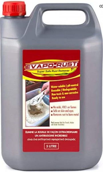

I'm also looking to de rust the bottom of my tank (NH). Have looked into the POR15 treatment/liner kit but am also worried about damaging the paint so considering light acid treatments (citric/vinegar/molasses etc). I don't see much mention in this or other forums of products like the one in the following pic, is there some reason why this wouldn't be suitable for treating rust inside a tank? It looks like it works quite quickly and is mild on paint.
john.whiting
- Posts: 1837
- Location: Brisbane QLD
Re: Vinegar to clean rusted tanks?
If you do buy Evaporust,be aware some of the stuff on sale is diluted solution,not the concentrate,and so dont get cheated on price......One chemical Ive heard mentioned is methyl salicylate ,called oil of wintergreen ,said by some to be very effective , however its very poisonous to cats and dogs.(for the same reason aspirin is).
MikeHenstock
- Posts: 26
- Joined: Mon Nov 02, 2020 7:59 pm
John, thanks for that. Subject to not getting a watered down version do you know is it likely to be effective (kill the rust / stop it contaminating the fuel after being flushed out) and not eat the good metal or the paint? Tank doesn't seem to be leaking so I don't think it needs a liner.
