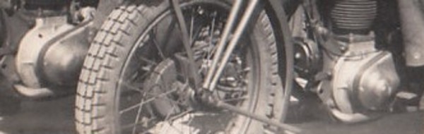

There has been a recent topic on the facebook page regarding the differing outer cases. Richard Thomasson pointed this out (different size bulge same casting number) and posted a photo (see below) he also said it was in Cheval somewhere?john.mitchell wrote:Paul, are you sure that the outers are the same. I think I wrote it up in Cheval but when I had Rigid 350 trials bike I used a drive sprocket set up from a twin because I didn't have a small enough single sprocket. It was fine for years and then I smashed the outer chaincase and when I tried to put on a spare it would not fit over the larger shock absorber and sprocket. I eventually found one which fitted and strangely it did not have different casting no. It seemed though that the bulge at the front was slightly larger on the one which fitted.
He said the smaller bulge may be WD. Certainly my WNG has the bigger bulge and is rough casting (typical of WNG cases) but no idea of its vintage. Looking at my collection of original WD images most have seem to be the larger bulge. However this photo does appear to show different sizes but its difficult to be certain. The Ariel on the right looks like an early one i.e. central speedo (changed to right side mount 1941/2) and screw on tank badges. Not too sure about the one on the left.
