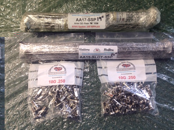

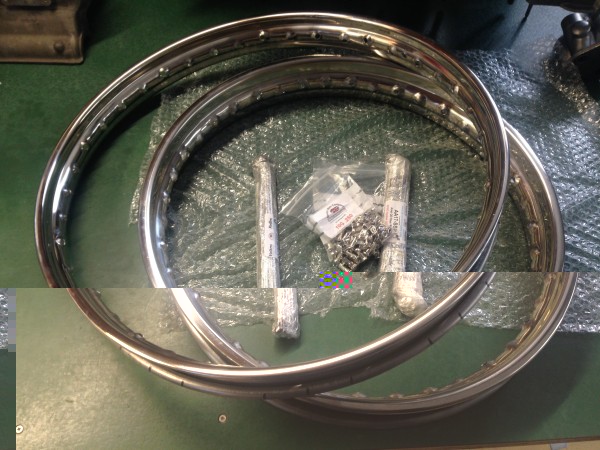

Just want to give a big thumbs up to Chris at the Devon Rim Company !
This time I ordered the Valtru variant, according to their website same quality but not so very polished as the Rolltru type, but cheaper (important for cloggies).
I ordered two specials for my ISDT replica Ariel, a 21" WM1 front and a 19" WM3 rear, both not standard in their list so they had to do one-off's .
Ordered last tuesday the 19th of november and today 22 nov. they arrived !
They are perfect, good stuff, good company.

But I suspect the spokes are not as per Ariel specification in terms of butting and head angle.
- Posts: 4841
Re: Devon Rim Company TOP!
rear are butted front are straight, so what is the matter ?

The Devon Rim Company rims are looking great, I did fit them also on my 1952 KH.
Can't tell about their spokes, as I fitted spokes which where made over here in Holland.
