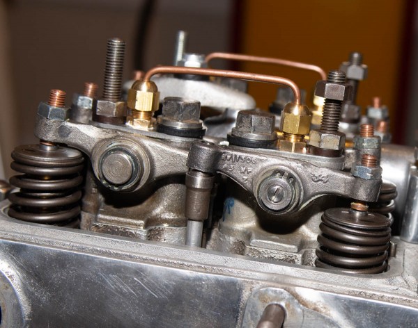

Sorry if I have asked you this before, but do you have the rocker oil feed pipes the right way round? big one to the gauge?

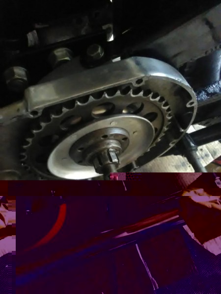

Regarding primary oil loss....without exaggeration, my bike would dump the entire primary oil out the shaft entry hole with 1min of running.....I bought and fitted aluminium thrower discs (purchased from Peter Kemp), which have proved effective....a fair bit of case fitting, removal and refitting as the discs were contacting a little. That bit can drive one a bit ga ga, but worthwhile. See pic attached. You can see the 2 discs riveted either side of the chain wheel.
I am also getting some vibration on handlebars at higher revs......this may be partly derived from my primary case woes, but I think more to do with mixture......more fettling this weekend!!
Cam
