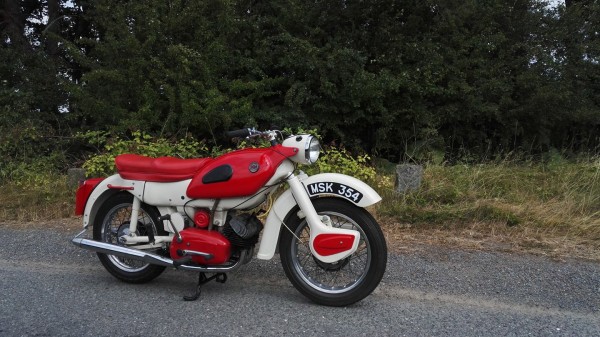

Attached pic of the bike this afternoon on one of my favourite back roads near Harewood House.

Hi Nige,
I believe the maximum safe limit for revs for a std Leader or Arrow would be 7000 rpm.
As to when you should change up, I prefer to listen to the engine note, rather than try and calculate what the max would be.
Is yours a 200, or 250? I can see it has high compression heads which will give it a little more power.
There is an old saying that says when riding older machines, 2/3 of the maximum speed it would have been capable of when new is plenty and safest if you want to avoid mechanical failures, but you are right when tuned they can be very quick.
