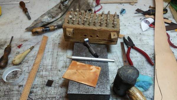

The vegetable tanned leather I'm using becomes very soft and malleable when it's wet. With a set of leather carving tools I made a small round Ariel Horse. I just traced it out onto the leather, cut the surface around the outline and stamped down the outside with the tools. After dyeing and polishing I sewed the straps and Ariel Horse onto the front.

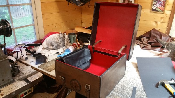

Made up a bottom lining that will hide the fixings on to the rack.
Just about finished. I've just got to make some p clips to fit to bike.
