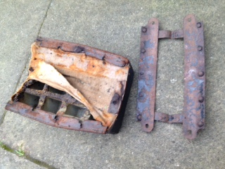

Hi simes,
Here are some photos of a period pillion pad that has fallen apart over the decades...
It has a Dunlopillo style pad but Might help you with options on shape.
I guess to replicate its spring-like characteristics and keep a good shape, you might consider a harder foam on top, softer beneath?
Rgds brian.
