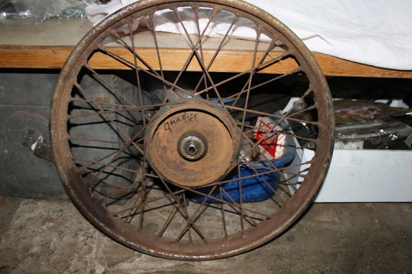

- Paul_Linden
- Posts: 698
- Joined: Sat Oct 15, 2011 10:08 pm
- Location: Exeter, UK
Re: Wheel rebuild Offset
Attached is a pic of my 54 Colt front wheel, taken to record lacing and offset before the rebuild. Just read the offset from the picture
