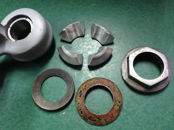

Before I knew that the tjechs make the best clamping rubbers (in thread of Marco's iron SQ4)
I made this :
It does clamp, but I dont know yet if it holds up in use..
