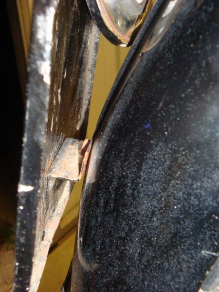

do you know if the rear number plate holder on the bike is original. I cant quite see enough of it. If so would you be able to post a couple of pictures and a couple of measurements please.

Hi David,
this is the same number plate holder as the KH.
It's an old restoration - my dad did it in the '70's - before repro., so I'm sure it is original.
If you need any more measurements, let me know.

I have now just completed the number plate holder. thankyou again for the photos and measurements.
