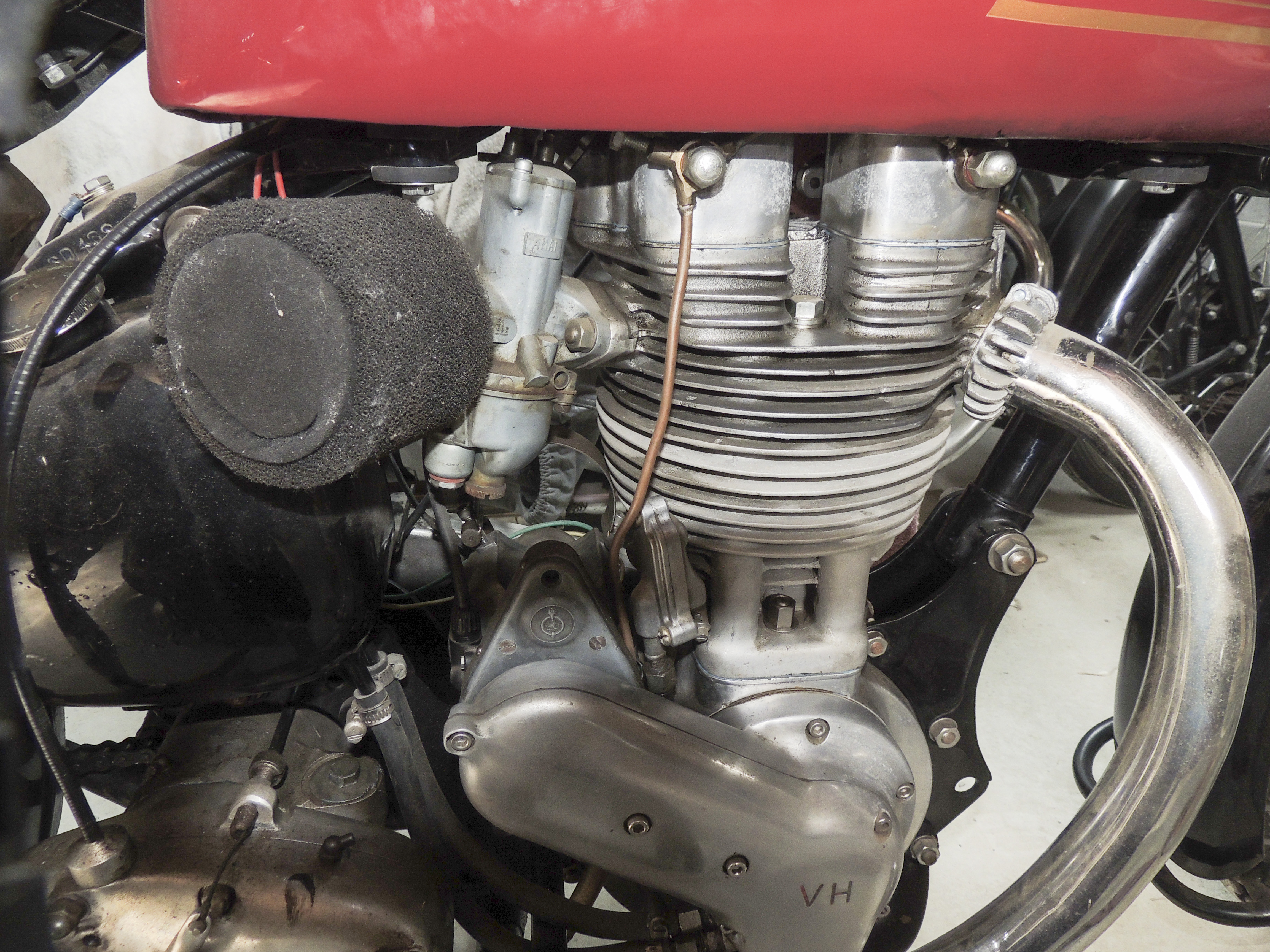

The VHA engine in the photo has the timing case breather elbow fitted upside down and the ball is removed. It breathes up through the reed valve and exits down through a breather hose. That engine is running 9 to 1 and does not weep oil at high speed.

Thanks guys. The reason I ask is that my '46 with a single ball bearing breather seems to pressurize at high rpm or wide throttle. I was wondering if a 2-way opening into the primary chaincase would allow the engine to vent pressure while drawing air from the relatively protected primary. It sounds like it needs the reed valve. Thanks for the picture!
I'm surprised that a 1/4" hole in the timing case is sufficient to vent the pressure of the engine at 6000rpm even with a reed valve so was considering adding a second reed valve at 2 o'clock in the drive-side crankcase. Is the 2 o'clock position the best?

It should be high up but anywhere will do, no doubt Ariel put it there as it was convenient for the pipe to run straight down, mine rises all the way to the rear of the bike and lubes the chain via the aforementioned Yamaha reed valve.
