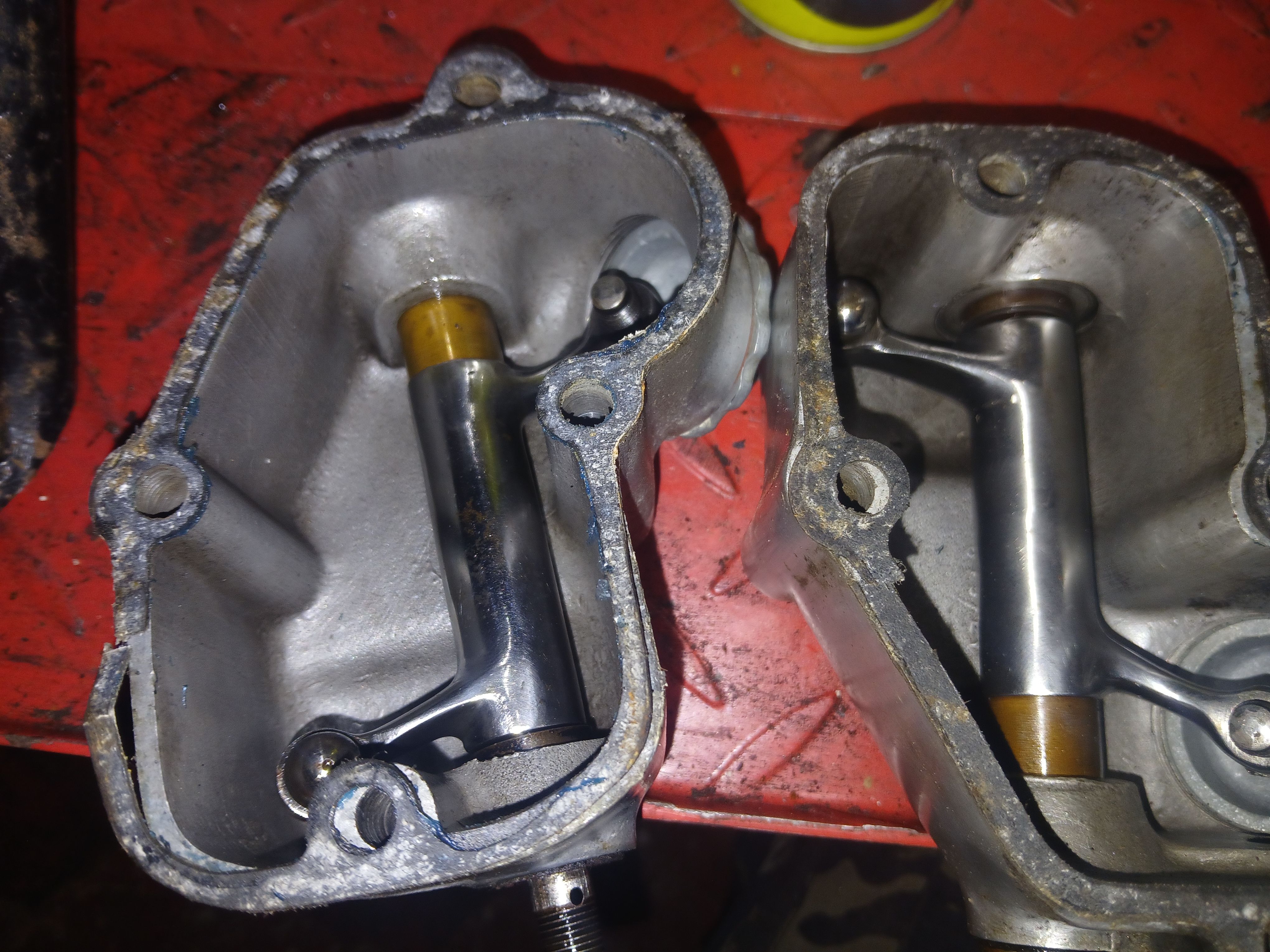

I couldn't work out how the valve lifter worked until I saw a picture of a normal rocker mine had been cut down and polished till it resembles chrome and no flat on it for the lifter ( which was blanked off ) which i manged to buy

I think your bike has been modified quite a bit.

So, its not normal for a 38 VH to have polished rockers or a polished conrod. Standard bore would be 81.8mm, so yours has been enlarged. The 2mm compression plate is also not standard - perhaps used to give valve clearance on the non-standard piston or control the compression ratio. A standard carb would be an Amal 89 or 289 which is, I think 1 1/8" bore.
So - far from standard...but...I'd think it would go well if you get it all sorted. I'd be interested to see what cam it has.

I'm not sure I'd rush to detune it unless its set up to run on alcohol. Check the valve springs are not too strong. The VH ones tend to be and that is hard on the cams Not required unless you want to Rev the Guts out of it. You can check the Cam lift by checking the Valve lift against stand OR the Push rod lift. I'd replace the Front rocker and set up the valve lifter again. It's good to Have when starting, Forget about Polishing the replacement. The rocker box Gaskets are THICK originally. Your motor may/will have Polished ports and Maybe enlarged (INLET) Valves If it breathes well it will want to go and will NEED a bigger carb than standard. Make sure the current Muffles doesn't apply much Back pressure, A domed piston gets hotter (more area) and needs more advance. Maybe some metal can be taken off the Crown but don't make it too thin.. I don't like the idea of compression Plates as it Makes sealing the cover tubes more difficult and doesn't locate as well and makes the engine higher, and there's not a lot of room there in the first place. Is it single Port? Have fun, A bit of extra Power wont bother you, After all they were called the Poor Mans JAP. Nev

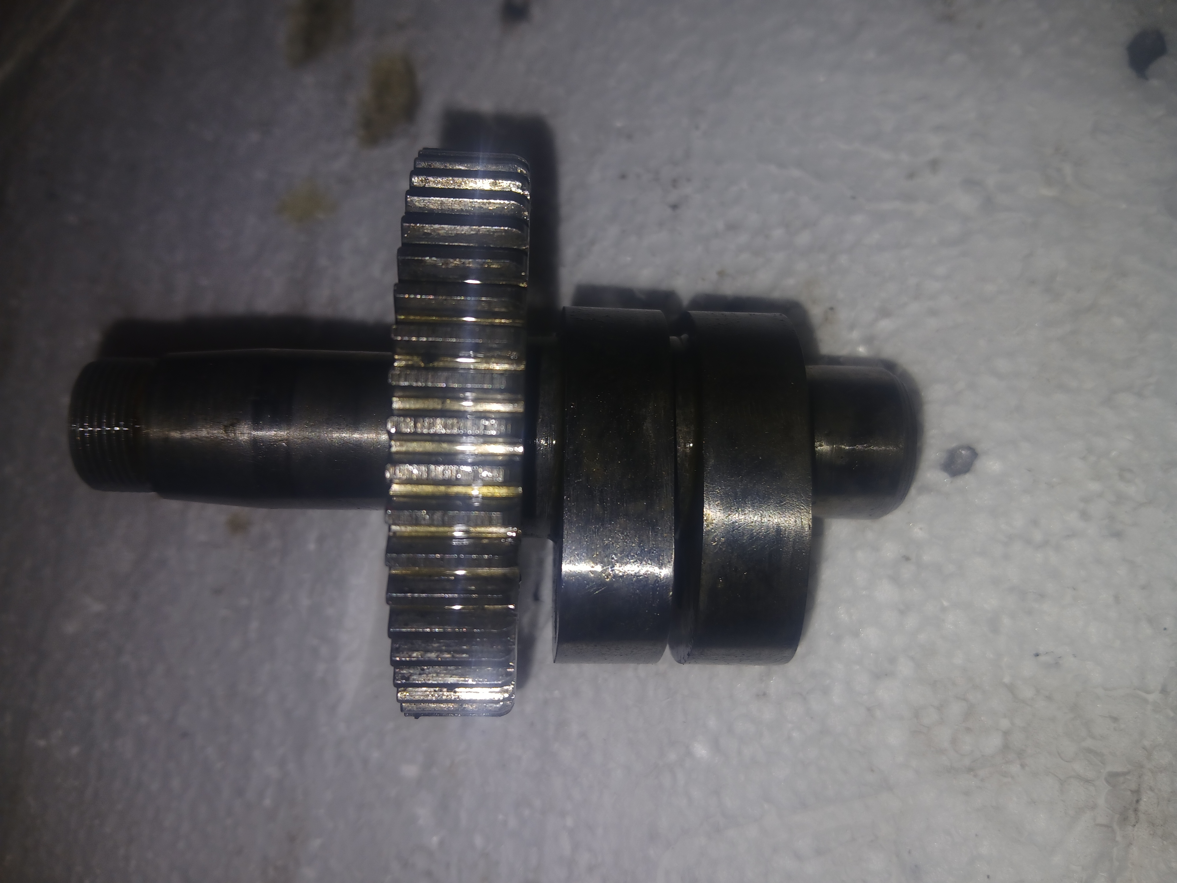

I think the cam is standard but id like confirmation before I put it all back and have a go at timing it etc
Iv never heard it run yet
- Posts: 3200
Re: More questions than answers
We will need an end on view of the cam lobes to be able to identify it. You may find it has a number stamped on the end, such as A6/664, A7/642 or F. Whilst telling us that number may help, it won't if the cam has been modified but we might be able to tell if it has had extreme modification.
