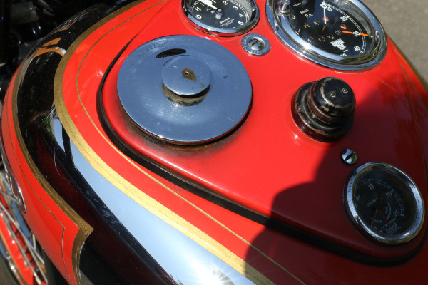

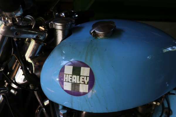

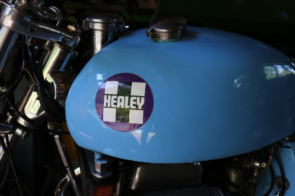

I paint all my petrol tanks myself, using a professional spray gun powered by compressor and using cellulose paint. I have never lacquered a petrol tank.
Below is a typical example of the problem caused by petrol leakage from the tank cap.
After a rub over with Triplewax Car Wax we are back to the following without removal of any paint:

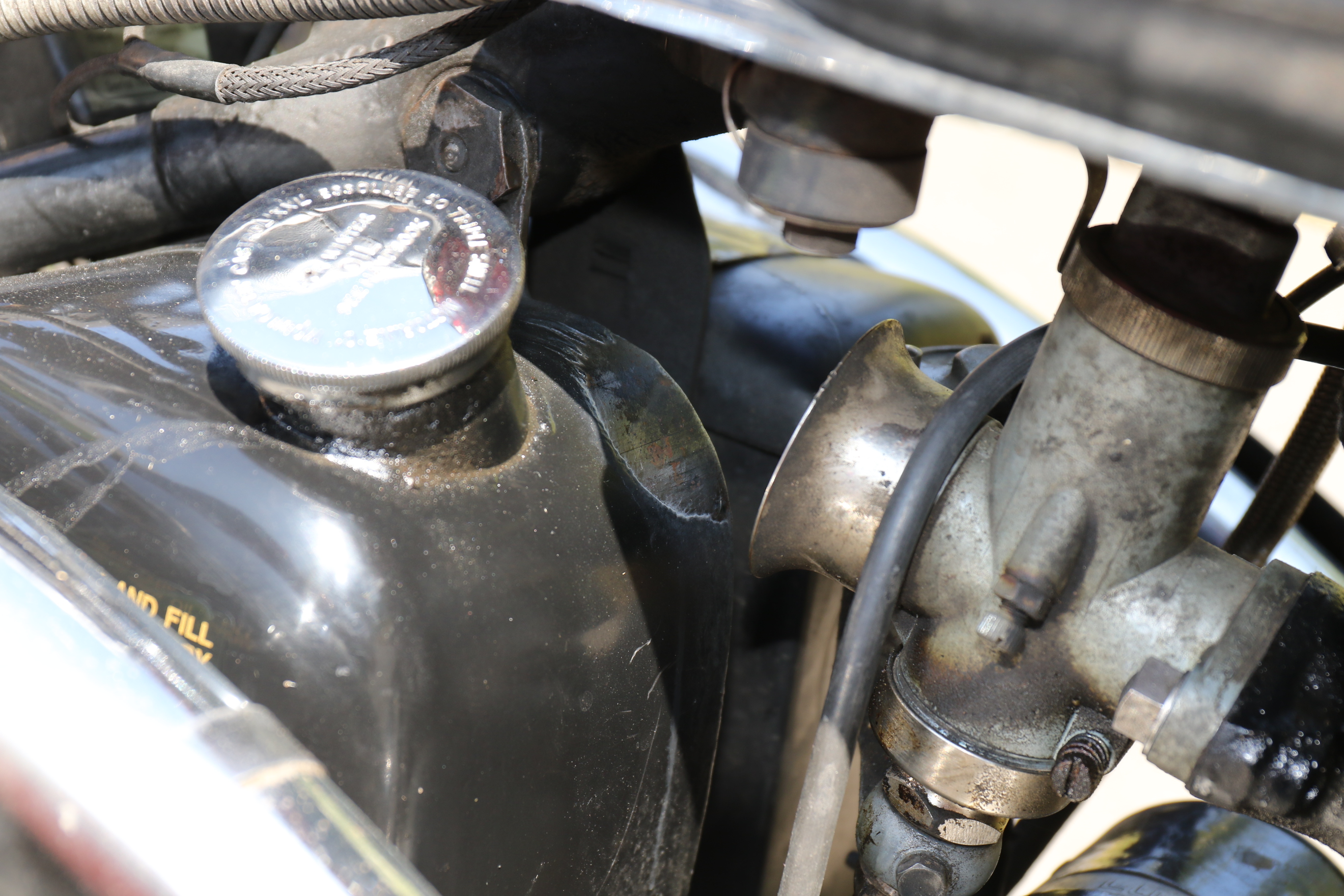

On the Red Hunter, the tank was painted in around 2014 but the panel was painted as long ago as 1990.
That said, I had an outbreak of idleness when I came to paint the oil tank for the Red Hunter and used rattle cans instead of the proper spray gun and cellulose. Most of the oil tank still looks ok, but look what spray or spitting back from the carb has done to the top corner.

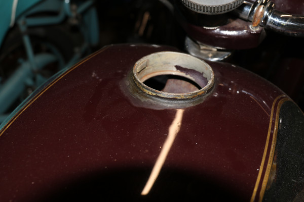

The worst damage has been done to my 1954 KH tank, which was painted back in 2009 and the bike has done around 17,000 miles since. (That long cream line coming from the filler neck at 5 o'clock is a reflection from the striplight above.)
Note that I have carefully removed the paint which was on the lip of the filler. If I remember correctly, the paint damage was largely done whilst the paint remained over the filler lip but once I removed the paint, the problem more or less disappeared. You do need as good a gasket under the petrol cap as you can find (or make). I have a suspicion that one made out of leather would be the best option but I am using standard grey gasket material at present.
