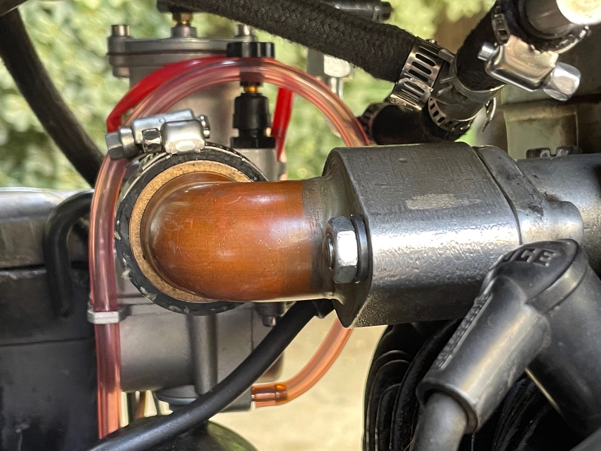

I have a 1948 Ariel Square Four 4G. The original Solex is junk. Couldn't get it to more than start and run poorly. I’ve tried maybe 8 or 10 different carb setups on it. Even a tiny 24mm Mikuni. Remember—the early 4G has the dynamo way up high so there’s precious little room for a larger carb.
I have made a 90-degree elbow manifold and have fitted a new PWK 30 carb that faces out the left side of the machine. I tried various Mikuni and Amal Concentric carbs there but the vacuum of the four cylinders pinned the slides to the bore of those carbs, holding the throttle open. The PWK flat slide (with a heavier return spring) doesn’t have that problem.
The bike will start easily but it had a flat spot transitioning from the idle circuit to the midrange. I dropped the needle clip to the #4 position (raising the needle one notch and enriching the mixture). The flat spot was gone.
But at idle the bike blows out thin black smoke and runs lumpy, indicating a rich mixture. I replaced the original #38 pilot jet with a #32 jet to lean it out. That did not appear to fix the problem. The pilot air screw adjustment seems to have no effect whatsoever on the idle. It can be all the way in or screwed all the way out. No difference.
Considering that this is a quartet of 250cc cylinders cycling in quite fast sequence (twice that of a twin), it seems that the idle setting for a 250cc single would be the key for this application, unless there are other dynamics in play, such as the continuous vacuum signal of the four.
Generally, the bike starts fine, can be made to idle (although with the idle speed adjustment screwed well in) and runs fine through the rest of the ranges, but the smoky, lumpy low end needs to be corrected. It seems the idle circuit isn’t in the game at all, since adjusting the pilot air screw has no effect.
Any experience with the PWK (it’s like a Keihin) carbs out there? I feel like I’m this close to getting it right, and the installation is clean and logical (although there’s no room for an air filter as it would foul the battery box).
Adapting a PWK 30 Carb to a '48 4G Square Four

Re: Adapting a PWK 30 Carb to a '48 4G Square Four
It seems to me that you need a PWK30, not a square four, expert; to answer your questions.
The fact that the idle mixture screw does nothing suggests that the throttle slide is already too far open at idle; and that most of the idle fuel is actually being supplied by the needle jet.
It may be that a 30mm carb is simply too big. The original Solex was a 26mm, reduced to 23mm.
Simon - The original Solex is all worn out and I couldn't get it to run right. Dragenfly had no parts for it.
nevhunter - The Amal slide carbs all jammed from the constant vacuum, but the PWK with optional stronger spring seems to work fine.
Chris ~ I believe you're right. But I can't find one, so I'm developing my own understanding of carburetion theory. I have a new 24 PWK. I'm going to try that on it. If and when I figure out the carb size, jetting, etc., I'll share it with the site so we all have a quick and easy "go-to." You'd still need a 90-degree adaptor though for an early 4G as the dynamo is so high up that there's no room for a float bowl.
